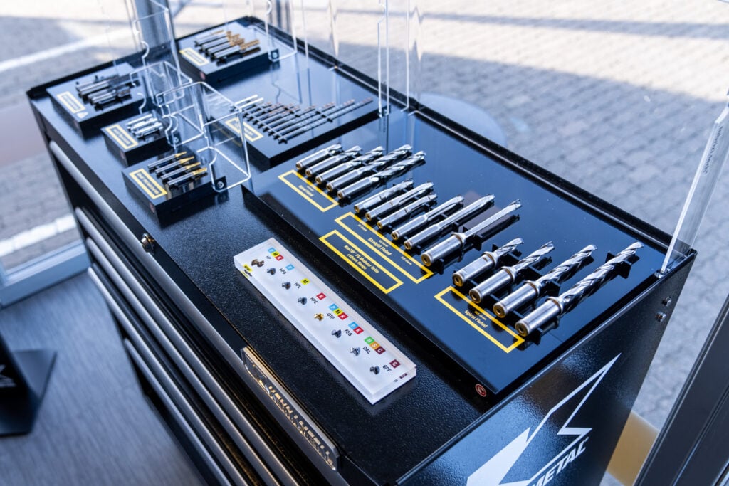

Inside the truck, the displays are organised around five representative orthopaedic components, giving visitors a clear, application-led view of how complete machining strategies integrate in medical manufacturing. Alongside these core displays, additional mobile units showcase Kennametal’s latest tooling innovations, allowing customers to explore new technologies and product developments in a focused, hands-on environment.
Each component walks through a full machining sequence. Along the bone-plate example, for instance, visitors can see how high-efficiency roughing with tools such as HARVI™ IV solid carbide end mills transitions into accurate finishing using HARVI™ I TE square-end and ball-nose cutters, before moving into micro drilling and threading operations. The emphasis is on how stability, surface quality and repeatability are maintained throughout the process.
Bone-screw machining highlights the challenges of small-part precision. Using the TopSwiss™ MBS tooling platform, the display shows how positive DCGT inserts, radiused side mills and micro drilling solutions are combined to produce fine features such as lead notches and deep cannulated bores with confidence.
For more complex geometries, the acetabular cup example demonstrates how tools such as Drill Fix™ PRO can support both pilot drilling and internal profiling in titanium, backed by proven turning and grooving solutions, including Kenloc™ and Top Notch™ inserts. Completing the journey, the femoral stem brings advanced five-axis machining into focus. Here, visitors can explore how HARVI™ IV roughing tools, radiused cutters and custom-form finishing tools are used together to generate complex shapes, smooth transitions and excellent surface control.
