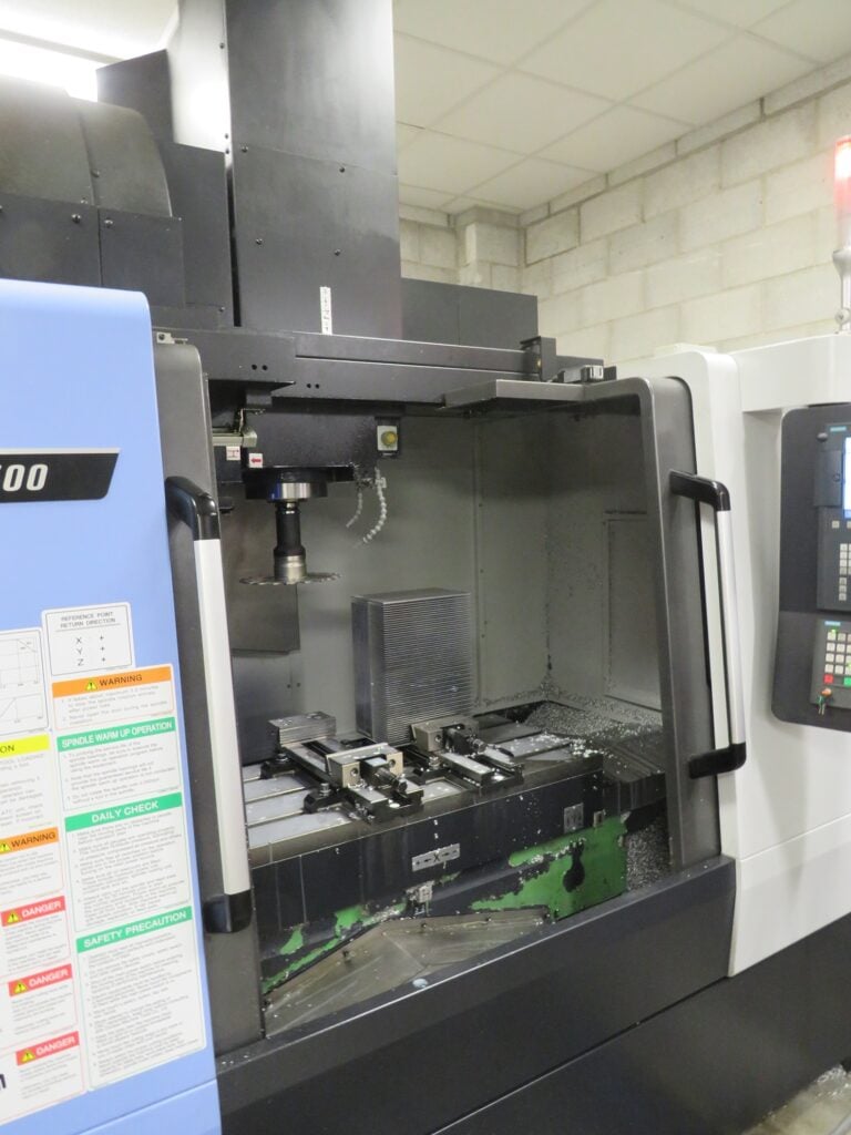

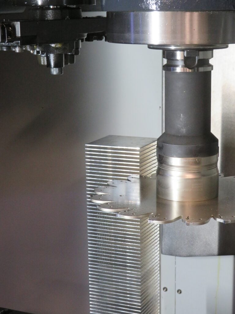

Looking at the job, CERATIZIT’s Derrick Jones proposed the CERATIZIT SX slotting cutter – an indexable disc milling system that presented a completely different approach. A 250mm diameter SX cutter body was specified, fitted with 4mm wide aluminium grade inserts matched precisely to the required groove width.
Now, the billet is shaped to create its external form and then secured on its side with CERATIZIT vices. It is machined using the SX cutter, which slices through the heat sink with 10mm depths of cut – a 10X increase from the previous method. Commenting on the new process, James says: “It’s like a knife through butter. Each pass is 10mm deep, the cycle time is now around 2 hours per heat sink, and the surface finish is much better with the finished part coming straight off the machine. We don’t have to do any post-process hand finishing, which could also prove time-consuming.”
With a cycle time reduction of approximately 70% compared to the previous end mill method, the SX slot cutter paid for itself almost immediately. However, it is the tool life data that clearly demonstrates the significant improvement the SX slotting system has achieved. The first set of inserts fitted when the SX cutter was introduced in May 2025 has lasted 10 months, completing more than 50 heat sinks.
“We only changed the inserts for the first time recently, after ten months of use across around 50 heat sinks with 96 grooves each – that is truly remarkable tool life. When you compare that with going through five or six end mills for every batch of 10 parts, the saving in tooling costs is significant. However, the biggest gain is the machine time and capacity that we have got back.”
