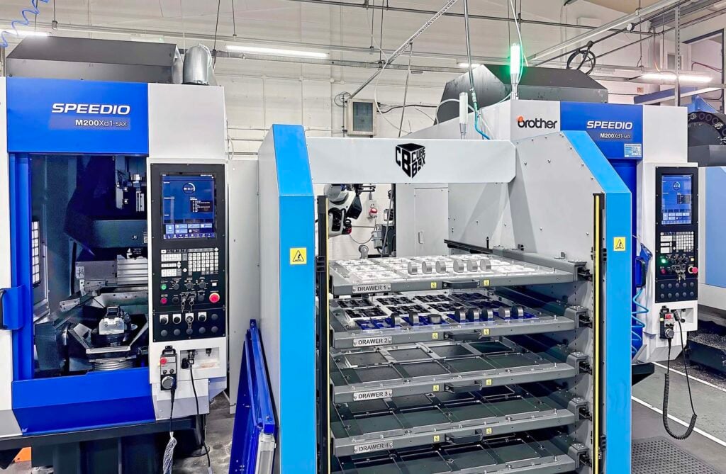

Subcontract machining firm Kirkstall Precision, Leeds, has enhanced its ability to serve the demanding medical sector with the acquisition of a pair of Japanese-built Brother Speedio M200Xd1-5AX 5-axis machining centres, served by a Tezmaksan robotic workpiece load, unload and storage system from Turkey. The cell was installed in two phases by Whitehouse Machine Tools, UK and Ireland sales agent for both of the overseas manufacturers.
For the past seven years, the subcontractor has focused almost exclusively on producing components for the medical industry, while also producing surgical instruments and implants for the veterinary sector. The company is seeing a 15 to 20% year-on-year growth rate due to high demand for its services.
The first Speedio with a 16,000rpm BBT30 BIG Plus spindle was installed in stand-alone mode in mid-2025 and selected for its accuracy, repeatability, versatility and compact footprint. Adam Thornton, Kirkstall’s Managing Director, said: “Accuracy in the medical sector is a given. Everything has to be completely correct, so we inspect and report all dimensional tolerances. Opting for a top-quality machine tool like the Brother was a fairly obvious decision for us.”
“We’ve used 40-taper 5-axis technology for some time, but the Brothers are faster and takes up less space. They are ideal for the smaller, high-accuracy parts we produce and deliver a 20% cycle time reduction compared with our larger production centres, typically.”
Approved to ISO:13485, Kirkstall mainly produces low-volume orthopaedic components from challenging materials, including stainless steel, titanium and other tough alloys. The 30-taper Brother machines are ideal for processing these materials. Additionally, they can combine 5-axis machining with turning on a single platform using the rotary torque table.
A notable attribute of the Speedio is its energy efficiency. Compared with traditional 40-taper machining centres, it consumes up to 80% less power, resulting in electricity savings of several thousand pounds a year. Energy-saving measures include power regeneration during deceleration, high-efficiency motors for spindle and axis motions, an optimised pump for coolant recirculation, LED lighting, low air consumption, and automatic power-off when the machine is not in use.
Low power consumption is not just through energy-saving features, but is also inherent in the machine design. Fast cutting speeds and rapids, plus an ability to combine milling and turning operations in one setup, lead to reduced cycle times and lower power consumption.
Second installation phase
The first Brother Speedio proved so successful in terms of production output and accuracy, despite the tough materials being machined, that in April 2026 the subcontractor decided to install a second M200Xd1-5AX and automate both of them with a single workpiece handling robot. The Tezmaksan CubeBOX Blues DR is a compact automation system with a 6-axis industrial robot and an integrated storage unit consisting of a five-level drawer stacker.
The configuration in Leeds is engineered to handle round billets from 5 to 550mm in diameter, with a maximum height of 135mm and a weight of up to 12kg. The system enables 24-hour production, including lights-out operation, with minimal operator attendance during daylight hours, boosting production output by up to 50%. Thanks to its standardised design, it can be installed in one day, offering a cost-effective alternative to bespoke automation and typically costing 20% less than machine-specific robot integrations.
A key advantage is the inclusion of the user-friendly RoboCAM smart automation software, which allows Kirkstall’s operators to convert 2D CAD drawings into robot instructions, without requiring robot programming or CAM knowledge. Manual unloading of machined workpieces and loading of fresh material for processing is accomplished while the robot continues to tend the two Brother machining centres. The system reduces human error, improves manufacturing quality and is expected to deliver a rapid return on investment.
