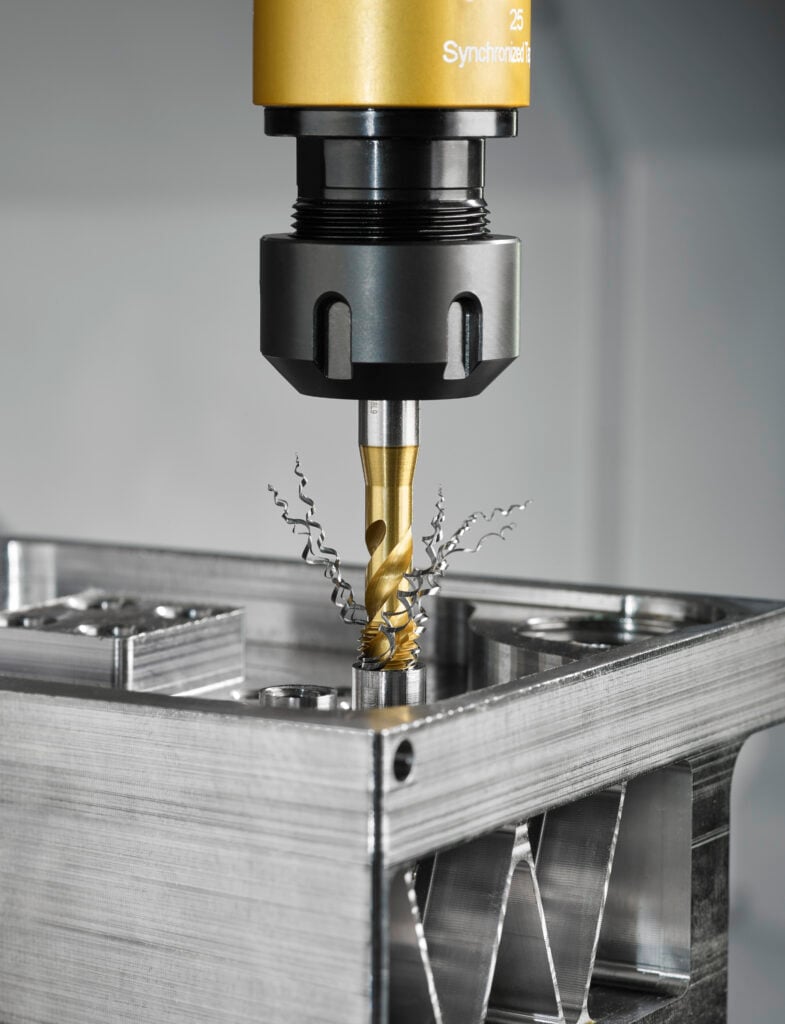

Holemaking at small diameters relies on concentricity, drilling strategy, cooling, and swarf removal. Walter’s DB133 Supreme micro drill is designed for these tasks, with geometry and substrate that ensure precision and reliability. When spindle speeds exceed 40,000 rpm, coolant filtration of 3 to 5 µm is vital to protect internal channels and extend tool life, a support Walter’s application engineering team can provide.
In threading, process reliability is crucial. A tap failure in a small bore can ruin a valuable component. Walter’s TC620 Supreme cutter is designed for speed and security, combining operations and reducing the risk of tool breakage—especially important when threading small parts.
