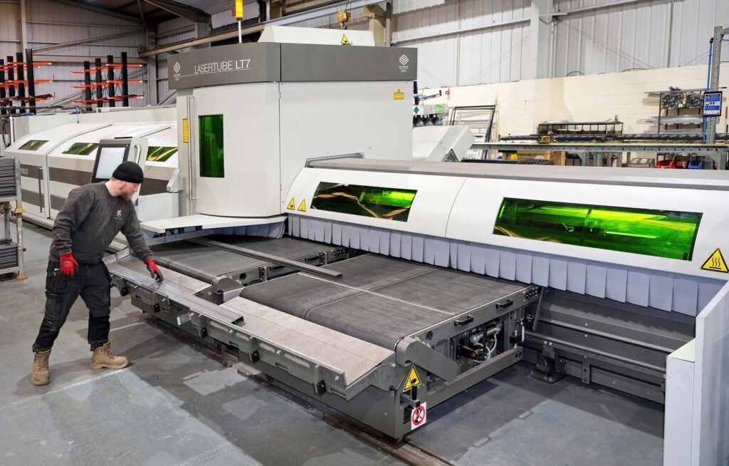

The BLM LT7 Lasertube and E-TURN 52 tube bender exemplify inter-machine communication. BLM’s ArTube 3D CAD/CAM software predicts how much tube will stretch during bending and instructs the laser cutter to offset hole positions accordingly. This calculation varies across the factory’s 60-plus mild steel and aluminium tube cross-sections, wall thicknesses from 1.2 to 2mm, and every bend angle. If the E-TURN 52’s sensors detect that the stretch deviates from the prediction, a correction is sent to the LT7 before the next cut.
“Inter-machine communication avoids problems caused by inconsistency in tube material, which can vary in wall thickness by 0.2 to 0.3mm,” says Openshaw. “It does not sound much, but it has a big effect on the bend. In-process adjustments are essential to ensure right-first-time production and prevent scrapped parts.”
Notable features of the LT7 include in-process stud rivet insertion and a 3D tilt-head that sculpts tube ends to sub-millimetre accuracy for optimal weld positioning.

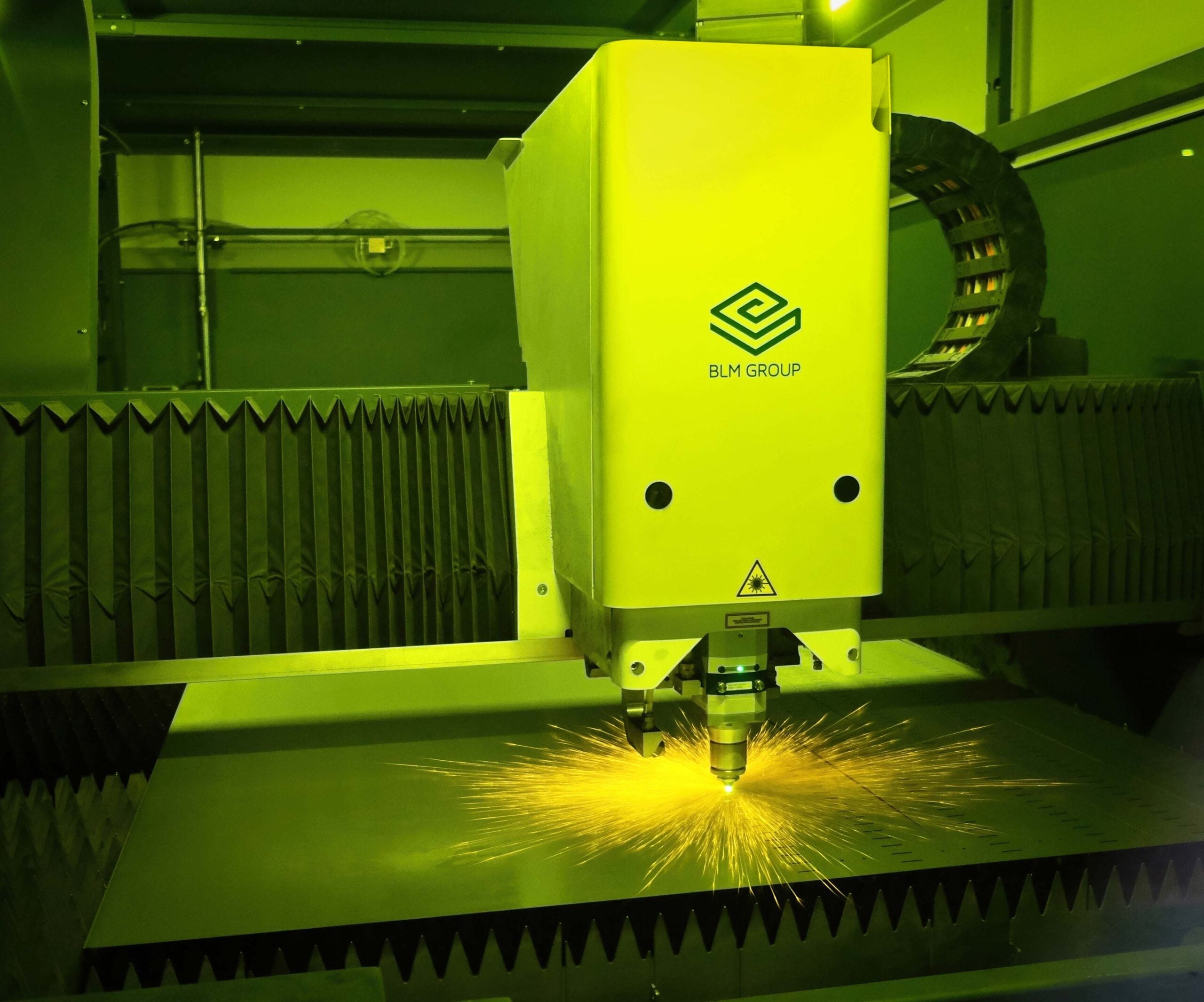

The BLM LS7 3015 flat-bed laser, powered by a 6kW fibre source, delivers simultaneous axis acceleration of 2g and a nine-second pallet change cycle. BLM’s Active Tools automatically adapt beam diameter and cutting parameters to maintain a burr-free finish, while an automated 18-position nozzle-changing magazine minimises setup time when switching material thicknesses. A camera-based nozzle wear monitor initiates automatic replacement before cut quality is compromised.
