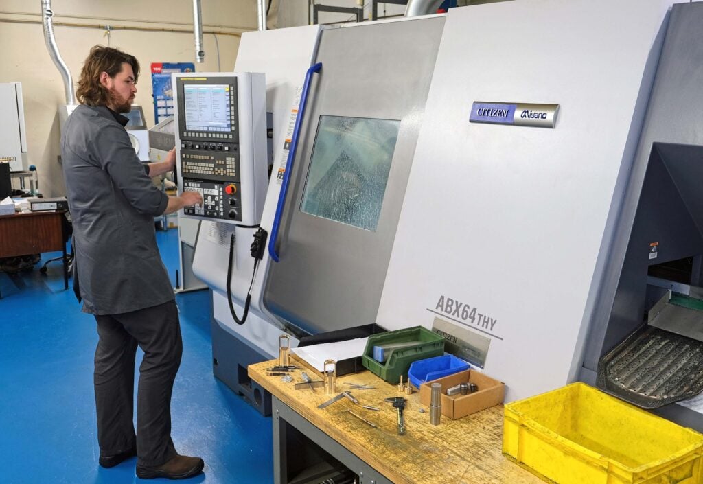

Prior to delivery of the third L20, to turn-mill larger components Meditech expanded its portfolio of Citizen lathes with a fixed-head machine from the supplier’s Miyano range. It was an ABX-64THY with three Y-axis tool turrets and a bar capacity of 64 mm. Delivered in 2015, it replaced a similar machine from a different supplier that was performing badly and set the medical equipment manufacturer on the road to becoming a Citizen-lathe-only company.
A similar Miyano with enhanced speed, power and thermal stability to allow longer periods of unattended operation, including overnight, was added in 2023 to expand production capacity for larger components, some of which are prismatic in shape without any turned features. Both Miyanos also benefit from superimposed machining capability, which enables three different tools to be in cut simultaneously for elevated levels of productivity.
