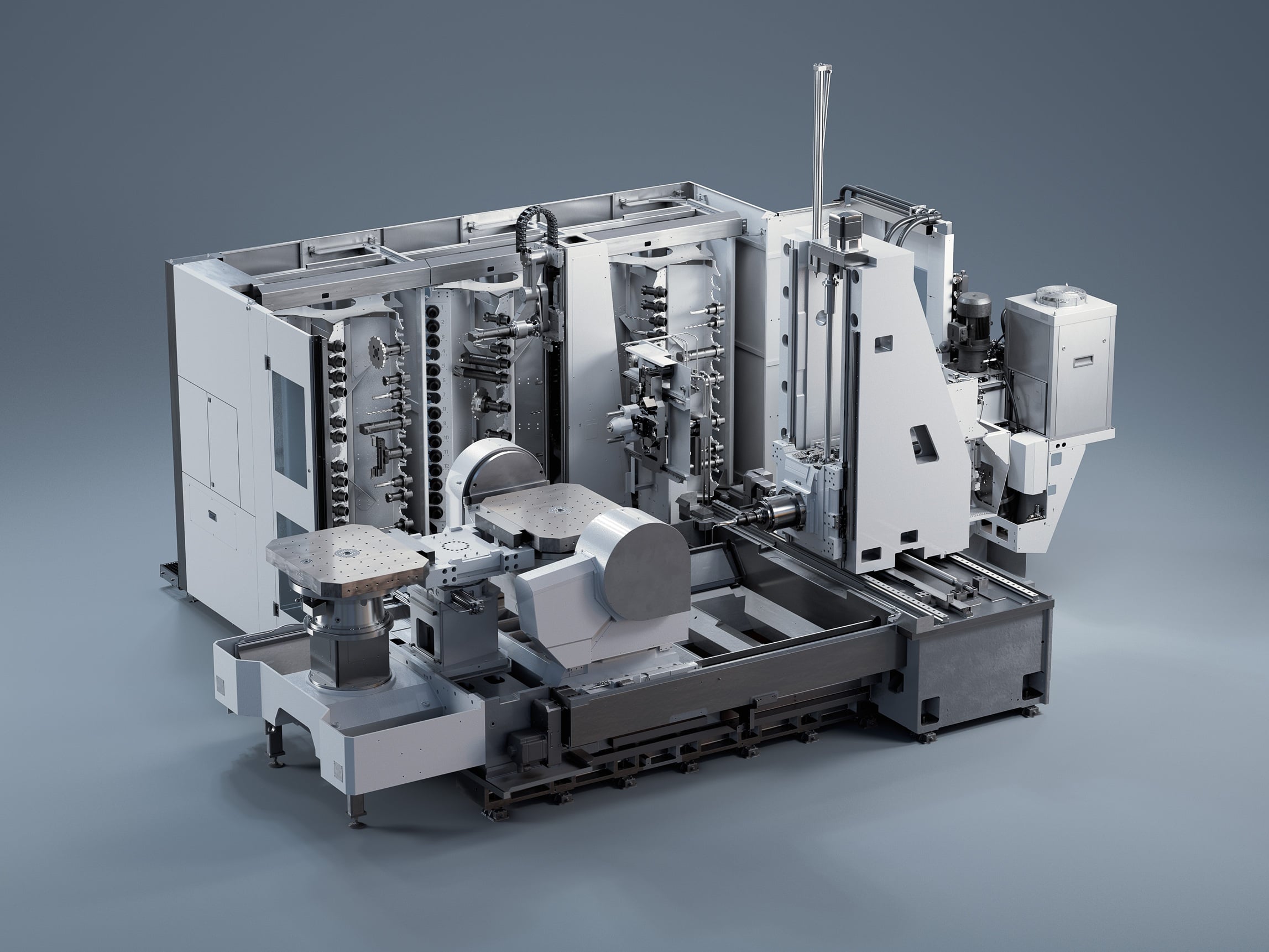

Starrag has introduced the Heckert X90, the largest and most capable model in its X-series 5-axis machining centre range, designed for high-precision, large-scale manufacturing in aerospace, energy and heavy industrial sectors.
Building on the established Heckert HEC series, the X90 features a workpiece-side swivel unit enabling complete 5-axis machining from a single clamping position. Axis travel measures 1,750 by 1,300 by 1,400mm, accommodating workpieces up to 1.6m contour diameter, 1m height and 2,000kg in mass — whilst occupying 18% less floor space than its predecessor within an 8.9 by 4.6m footprint.
Productivity credentials are impressive: traverse rates reach 65m/min, pallet changes are completed in 22 seconds, and chip-to-chip tool change times are just 8.3 seconds. Spindle options vary from 12,500rpm hollow shaft to 15,000rpm motor spindles, with gear spindles available for heavy-duty cutting. Tool magazines provide up to 120 HSK-100 positions, supporting extended unmanned production runs.
The X90 is operated through Siemens SINUMERIK ONE, paired with Starrag’s ergonomic 24-inch glove-friendly touchscreen HMI. Built-in automation interfaces support circular and linear storage systems and robotic cells. An optional turning package allows for both standard and complex turning operations at the same productivity levels as machining centres.
Pallets are interchangeable with Heckert H-series and HEC 630/800 X5 machines, protecting existing customer investment.
