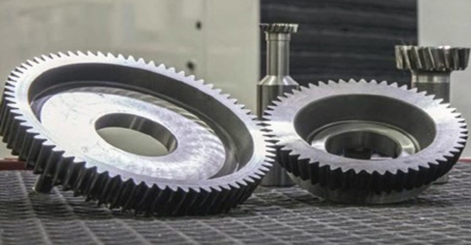

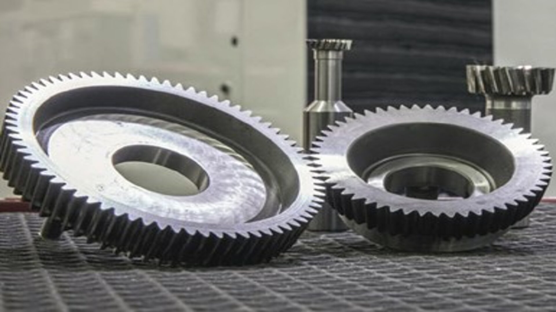

The ANCA GCX is a specialised machine for grinding skiving cutters used in the production of internal and external gears for electric vehicles. The drivetrain of electric vehicles includes a high-speed gearbox. The correctness of this gearbox’s components will affect the lifetime, efficiency, and noise of electric vehicles. MTC is a critical enabling technology for the GCX to generate AAA-class cutters. It is used to regulate the temperature of a dressing spindle, which is utilised to create a high-precision profile on a grinding wheel. MTC is also used to regulate the temperature of the primary grinding spindle during up to 12 hours of continuous grinding.
