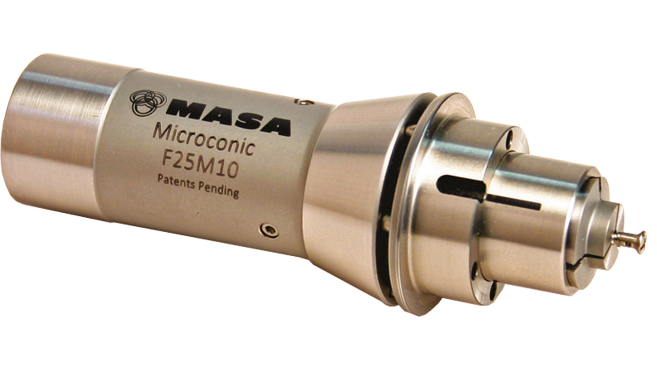

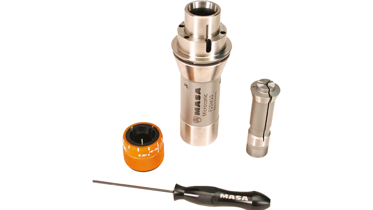

The remarkable Microconic workholding system consists of a cartridge and precision collet. The collet fits inside the cartridge and accurately adjusted before it is fitted directly into the existing collet sleeve. No machine adaptations are required and this didn’t go unnoticed at the recent Star and Citizen Open House Events where visitors were once again suitably impressed.

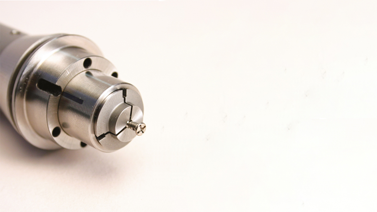

Available with clamping diameters from 0.2mm to 10mm, the collets can clamp the most fragile of parts with precision. With a concentricity level between 3 to 5 microns, the MASA Microconic System is ideal for sliding head lathes like Tornos, Citizen, Star. Until now, the system was only available for F20 and F25 style collets. Now, MASA has extended this line-up to add the new F37 (1536E) cartridge for 32mm diameter capacity machine tools. This has also been joined by the new F20-201 (136E) system that is specific to Tornos machine tools.
The Microconic cartridge system from Floyd Automatic incorporates a solid extended nose that is extremely rigid and robust for impeccable precision, repeatability and concentricity. Uniquely, the new device has the facility for micron-adjustment of the collet closure, ensuring that even the most fragile of components can be securely clamped. To confirm precision levels, the hardened and ground cartridges can be used as gauges to verify machine spindle accuracy.
