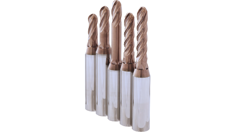

The new four tooth finish milling cutter with shank integrated cooling is available in the diameter range of 1 to 8mm for milling depths of up to 5XD. This milling cutter is suitable for machining all materials up to a hardness of 54 HRC and its development has been focused upon stainless steels, titanium, heat resistant alloys and nickel and chrome-cobalt-alloys. Hence it is not surprising that these tools are especially convincing with extremely high performances levels when working with these materials.

Two versions of the CrazyMill Cool Ball Z4 are available with especially long cutting edges. These have progressive spiral flutes (from 30º to 40º) that guarantee vibration free milling. The angle of 30º at the tip avoids an accentuated interface between the cutting edges and the cylindrical section, reducing the risk of cutting edge break-out. These versions are especially suitable for side milling because the entire depth can be machined with minimal passes or even just a single pass.
