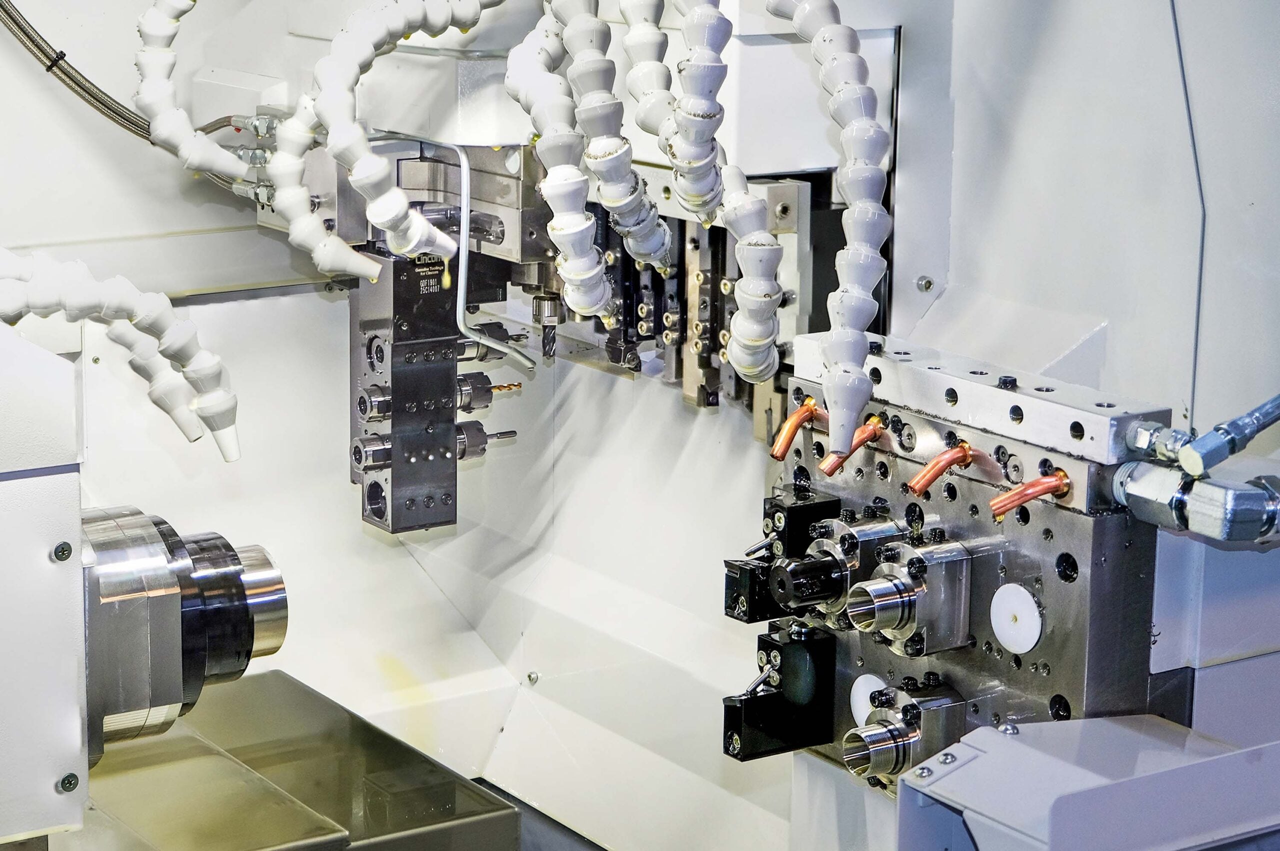

Trouble-free lights-out machining largely depends on Citizen Machinery’s low-frequency vibration (LFV) chip-breaking functionality, which is especially effective when machining malleable materials. Built into the Mitsubishi control’s operating system, LFV breaks what would otherwise be stringy swarf into short, manageable chips without lengthening run times by inserting macros into cutting cycles. It prevents damage to the workpiece and/or tooling and avoids the need for an operator to be in attendance to clear accumulated swarf from the working area.

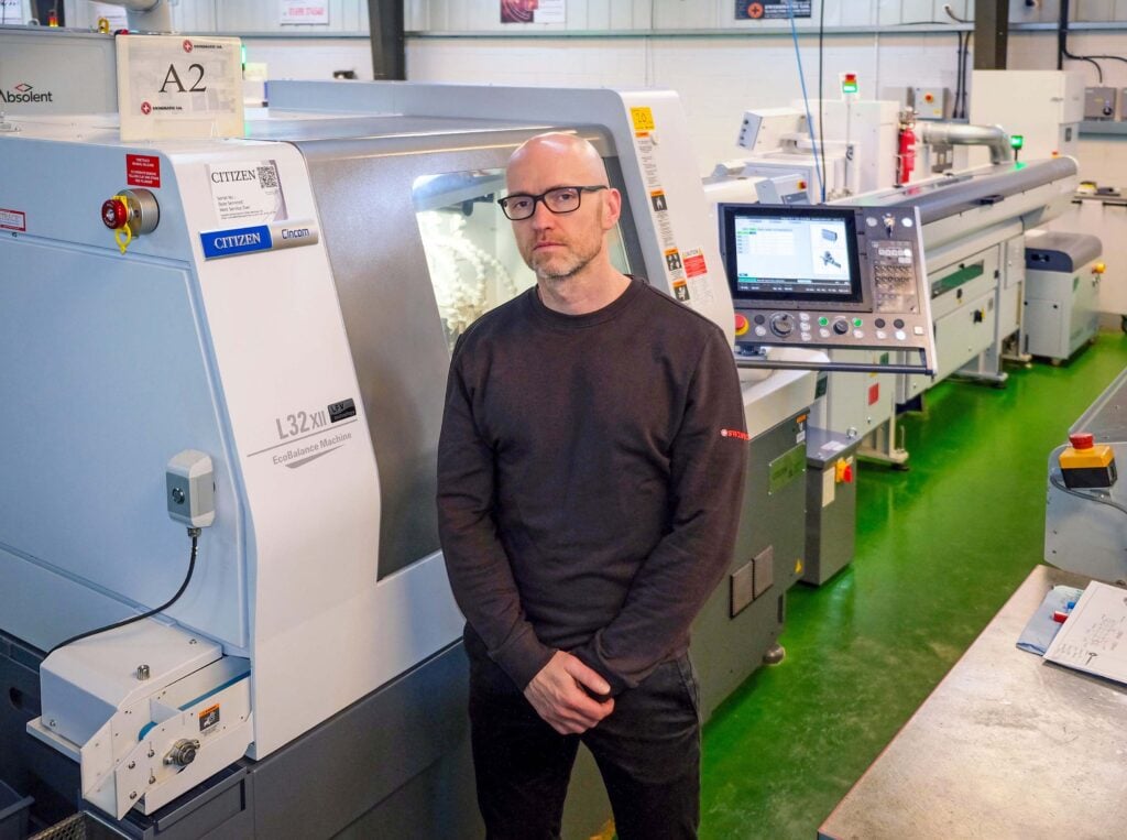

The latest Citizen Cincom sliding-head lathe to arrive on the shop floor in Wishaw was a Series 2 L32-XII B5 LFV with a B-axis swivelling tool carrier. It was the first of its type to be installed in the UK and one of only a few that currently sport the newly-upgraded 4-axis LFV capability. Operating in X and Z at both spindles simultaneously, it removes the need to compromise by switching the function in and out via G-code at a single spindle.
Replacing a less advanced, 32mm-capacity sliding-head lathe, the 9-axis CNC machine features +90/-45 degree B-axis rotation of a driven tool post positioned at the far end of the front gang tooling, enabling full 5-axis simultaneous machining. For maximum versatility, the rotary tools can work on either C-axis spindle to produce angled features. The lathe is also capable of superimposed machining, which uses a master-slave relationship between the linear feeds of the sub spindle and the tool carriers to reduce cycle times by allowing more than one tool to be in cut at the same time.
Before this machine was installed, the previous two Cincoms purchased by Swissmatic were M-series lathes with gang tool posts and a rotary turret with 10 driven tool positions. This feature is not found on any other make of sliding-head lathe in the Wishaw factory, making Citizen the preferred supplier of such machines for more complex production applications. An M32-VIII LFV was delivered in mid-2022, and a smaller M16-VIII LFV arrived at the end of 2023.
