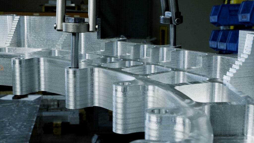

Production is about 80% aluminium, with titanium, Inconel and other hard metals making up the balance. The parts range from ribs, stringers and formers to fuselage sections. As COO Arnie Juarez illustrates: “We recently had a billet that weighed about 6,800lbs, but when we shipped the part out, it weighed 190 lbs. That is 95% material removal, and that is common for us.”

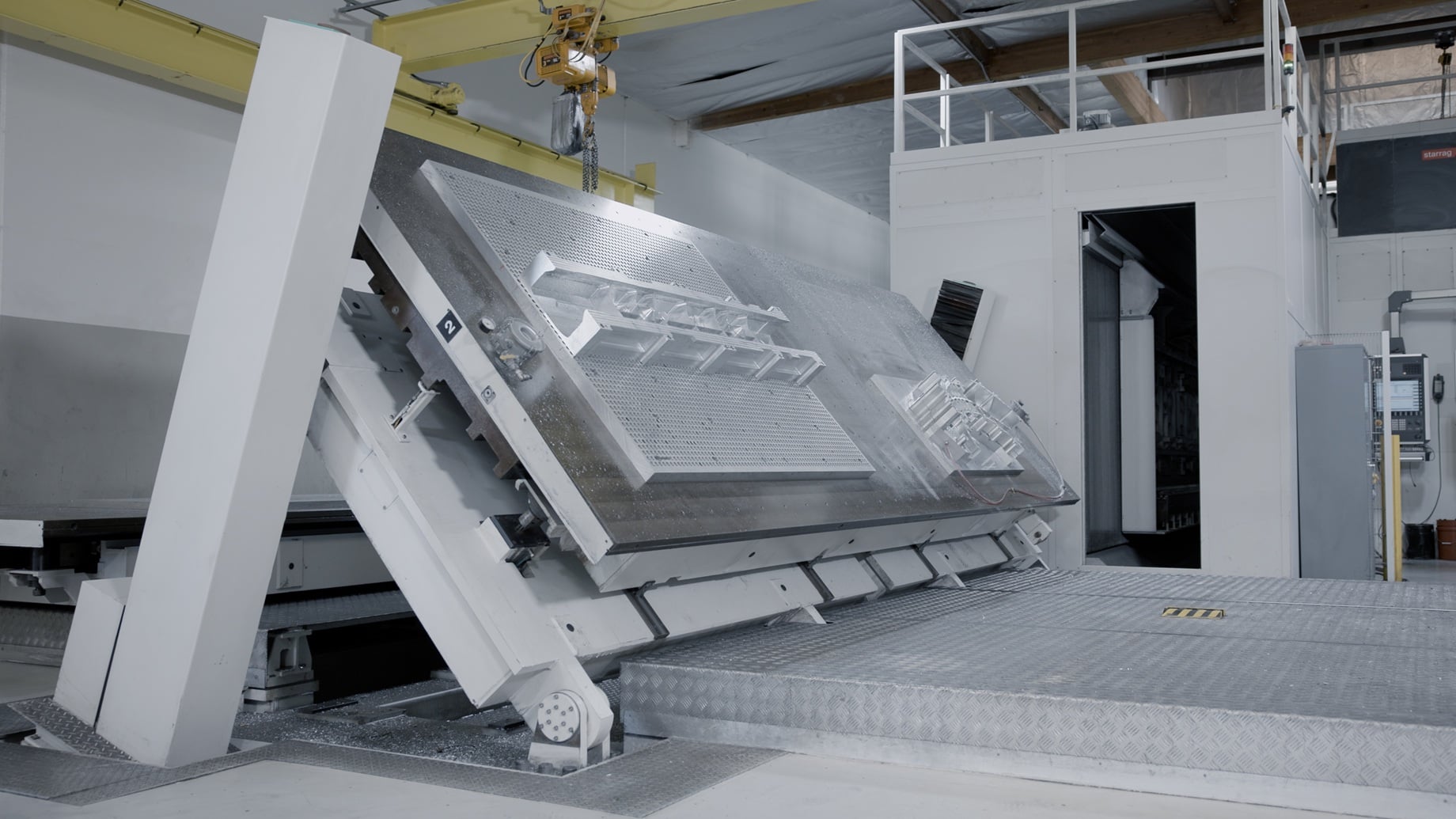

The 2060, with its 2m by 6m envelope, still holds tolerances to within a thousandth of an inch after 13 years. “We haven’t had any major overhauls,” says Juarez. The newer 1540 (1.5m by 4m) complements rather than duplicates it, freeing the larger machine from smaller work. The 2060 uses minimum-quantity lubrication; the 1540 uses flood coolant, letting Notthoff optimise each for different parts. Both run 24/7 on Siemens 840D controls, with dual pallets, 120-second pallet changes, and every programme validated in Vericut.
