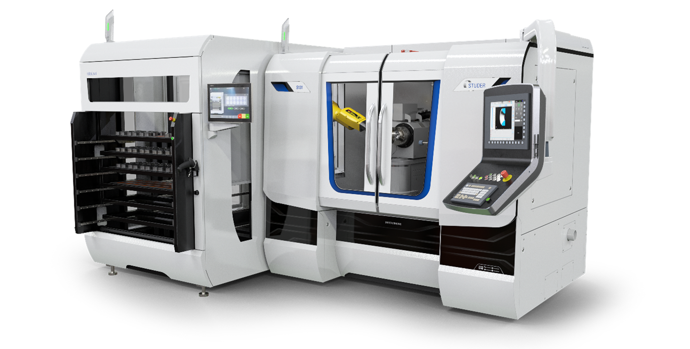

In the STUDER S121, S131, and S141 radius internal cylindrical grinding machines — which, as an example, are used in the packaging industry for the production of dies — the automatic B axis has a swivel range of -60° to +91°. “That’s why the automation has to get out of the machine to give it the freedom to swivel,” explains Daniel Schafroth, Systems Division Manager at STUDER.
Large storage capacity

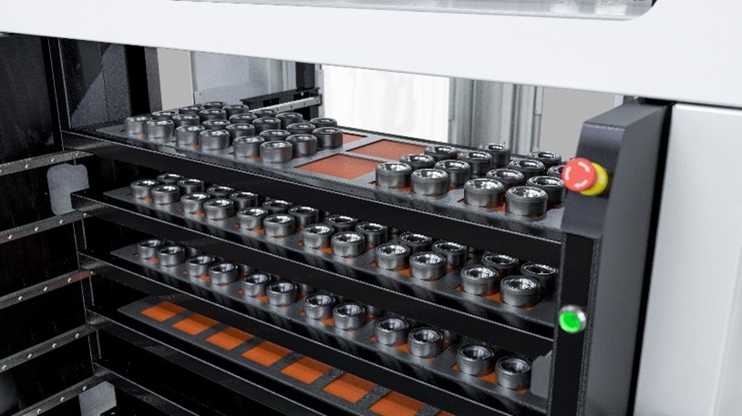

That is why STUDER has now developed the roboLoad, an external loader that with a width of 1.50 meters (59,06″) is only half as wide as the machine itself. “This is not insignificant,” emphasises Schafroth, “Because the floor space in modern production halls has to be used efficiently.” In this comparatively small space, the roboLoad offers plenty of room for workpieces on six trays, each measuring 1080 x 320 millimetres (42,52 x 12,6”).
The trays are loaded manually. “We are not talking about large-scale production here, but about unmanned production during the night shift, for example, or making good use of breaks in other production processes,” Schafroth emphasises. Any grinding program can be called up for the workpieces. The STUDER roboLoad processes these and places each workpiece back in the same place after machining.
