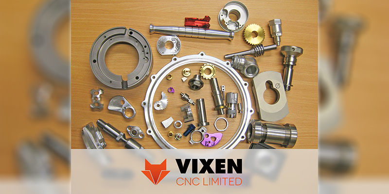

The very first of the new SX machines has been pre-ordered by Vixen CNC Limited, a specialist supplier of mill-turn components located in Gwynedd, Wales. With 20 existing Star models on-site offering up to 42mm diameter capacity, the acquisition of a new SX-38 further enhances its machine tool portfolio and marks another significant milestone in the growth of the business.
Vixen CNC’s Managing Director, Jake Wood, says: “Remaining at the forefront of the turned parts industry is of great importance to us and our continued investment in the latest Star technology allows us to offer customers unparalleled response times, superior quality and full manufacturing flexibility.”
He continues: “The SX-38 offers significant benefits and further increases our sliding head capabilities. We work with a vast range of materials and supply finished parts to a wide array of sectors including automotive, medical, marine and fasteners. Our new SX machine will give us the ability to explore additional business opportunities and reinforce our position as a leading global supplier.”
