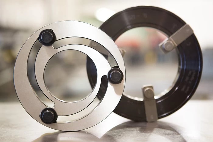

Star Cutter Company has unveiled its advanced Double Pilot Reamer, a precision-engineered solution designed to deliver exceptional size control, superior surface finishes and significantly extended tool life in demanding barrel machining applications. The innovation targets industries where deep-hole accuracy and consistency are critical, including aerospace, automotive, defence, hydraulics and medical manufacturing.
The Double Pilot Reamer is specifically developed for deep-bore and high-precision operations where maintaining dimensional accuracy, straightness and surface integrity is essential. It is well-suited for components such as hydraulic cylinders, pneumatic systems, aircraft structures, engine and powertrain parts, as well as orthopedic devices and industrial cylindrical components that require tight tolerances over extended bore lengths.
A defining feature of this tool is its fully guided cutting approach. Unlike conventional reamers, the Double Pilot Reamer is supported throughout the entire length of the bore—from entry to exit—ensuring continuous alignment during machining. This design significantly reduces tool deflection and vibration, two major factors that often lead to inconsistent results in deep-hole operations.
By maintaining stability during cutting, the tool effectively eliminates common machining issues such as chatter, scoring and witness lines. These defects are typically responsible for scrap, rework and compromised surface quality in barrel machining. With these challenges addressed, manufacturers can achieve more consistent output while reducing production inefficiencies.
The enhanced stability also translates into improved process reliability. In high-precision environments where even minor deviations can lead to rejection, the Double Pilot Reamer provides the confidence needed to maintain strict quality standards. This is particularly valuable in sectors like aerospace and medical manufacturing, where precision and repeatability are non-negotiable.
Another key advantage is the significant improvement in tool life. According to company insights, manufacturers using the Double Pilot Reamer have reported tool life increases of up to ten times compared to conventional reaming tools. This not only reduces tooling costs but also minimizes downtime associated with tool changes, contributing to higher overall productivity.
The tool’s ability to deliver superior surface finishes further enhances its value proposition. High-quality finishes reduce the need for secondary operations, enabling faster production cycles and improved throughput. This makes it an efficient solution for manufacturers aiming to optimize both quality and cost-effectiveness.
Overall, the Double Pilot Reamer represents a meaningful advancement in holemaking technology. By combining precision guidance, vibration control and durability, Star Cutter has developed a solution that addresses key challenges in deep-hole machining. As manufacturers continue to push for higher accuracy and efficiency, tools like this will play a crucial role in enabling consistent, high-quality production outcomes.
