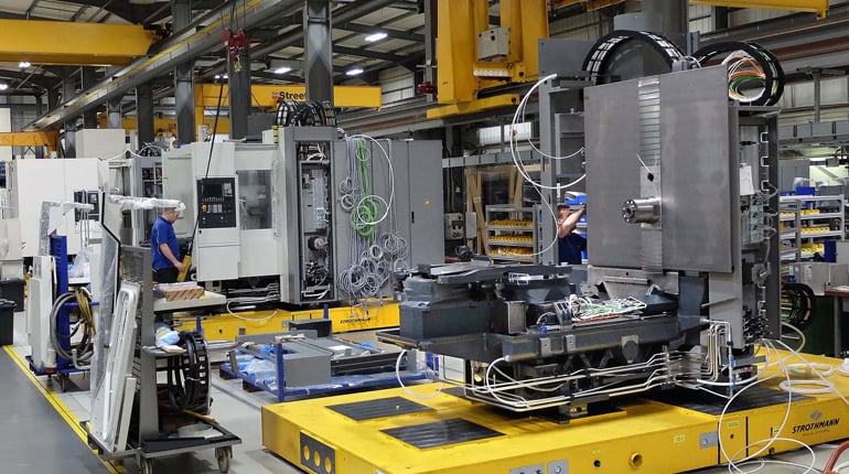

Mechanical assembly of horizontal machining centres is completed over the first four stations in the line. All bed assembly is carried out off-line and the casting is delivered to the first carriage with the linear guideways already fitted. A majority of the pre-assembled groups of components are added at this first station, including the machine column, pallet changer and the energy unit powering the hydraulics and pneumatics.

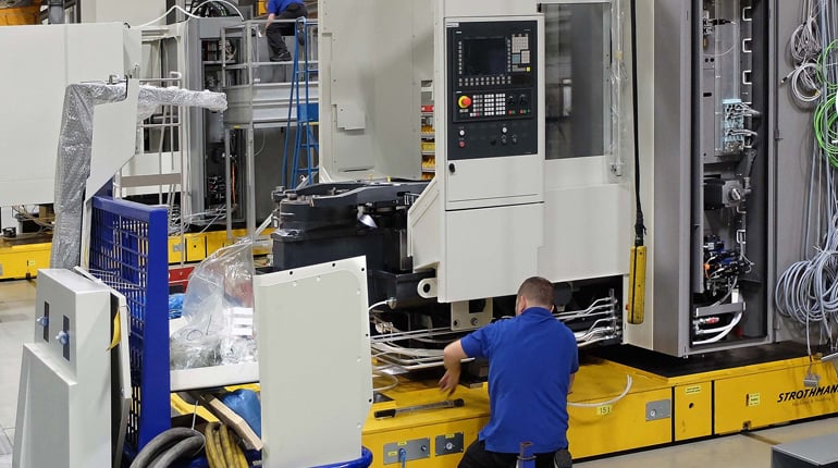

The Strothmann carriage is raised pneumatically and pushed along rails set in the floor to the next station location, where the air pressure is released to allow the carriage to lower to the floor, a process that takes about two minutes. The main part of the work here is to attach the electrical cabinet, which is craned across from another part of the factory. Some of the ancillary equipment including cables and pipework is also fitted.
At the third station, two further major groups are added, namely the tool magazine and changer assembly and the machine guarding. Station four, which completes the mechanical assembly phase, sees all of the pipework and cabling routed from where it originates to where it needs to be connected.

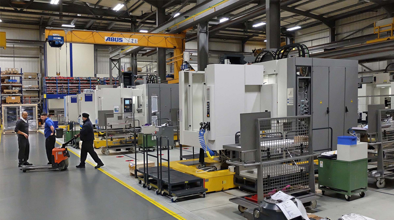

Electrical commissioning can take two, three or even four days, depending on the technicality of the software, customisation and everything else that needs to be completed, so occupies the next one or two stations. Later stations in the line are deployed similarly flexibly according to the amount of work required. It includes geometrical alignment, laser calibration of the axes to ensure repeatability of the machine and an alignment test carried out by a dedicated team in the Heller factory.
The last part of the process is to machine a standard NAS (National Aerospace Standard) test piece, which is inspected by an independent team of metrology staff to give the customer a guarantee of the machine’s accuracy.
