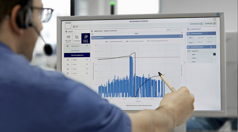

The HELLER4Services interface focuses on transparency of digital manufacturing and maintenance. The module forms the basis for evaluating machine data and statistics to reduce downtimes. Additionally, visualisation of specific information such as status displays of axes and spindles enables users to predict wear and implement preventative maintenance to avoid unscheduled downtimes.
HELLER4Performance includes workpiece-specific analysis for optimisation of a process and extraction of real-time data over the internet, plus evaluation and graphical display in the cloud.

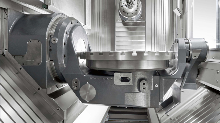

The HF 3500 is intended for 5-sided or simultaneous 5-axis dynamic machining of medium to large batches of complex prismatic parts, from small workpieces to heavier components up to the 550 kg maximum table load. An optional Speed Package enables 10 m/s2 acceleration and rapids of 90 m/min to be achieved, reducing chip-to-chip time by approximately 10 percent compared with the standard machine.
Working volume is defined by X / Y / Z travels of 710 / 750 / 710 mm, with generous interference contours. Feedback of axis position to the control is via linear scales for maximum precision. The machine can be equipped with a lift-and-rotate pallet changer for series 5-sided production, while pallet automation solutions are available.
The fourth and fifth axes are provided by a rotary table on a +30 to -120 degree swivelling trunnion, both with direct drive, which moves towards the spindle rather than vice versa. According to Mr Meyer, the configuration minimises vibration of the spindle and hence of the cutter for better component accuracy and increased tool life.
Four motor spindle options are available with speeds up to 18,000 rpm and torques up to 354 Nm. The lift-and-swivel toolchanger has two NC axes for short idle times and consistent operation. Chain-type tool magazine capacities are HSK-A 63: 54, 80 and 160 pockets or HSK-A 100: 50, 100 and 150 pockets. A central, open chip conveyor ensures efficient swarf collection and removal, already promoted by the free chip fall characteristics of the horizontal-spindle design.
Main target customer groups for HF series machines are the automotive supply chain and the general machine building industry, although it is interesting to note that the first HF 3500 off the UK production line went to an aerospace subcontractor in the West Country.
The machining centres are characterised by inherently rigid construction of the bed and column, while the trunnion is supported by a counter bearing for dynamic rigidity even at high loads. Recently, Heller demonstrated impressive cutting capabilities. Using a 100 mm diameter face mill, a chip removal rate of 470 cm3/min was achieved when machining 1.2312 steel with an axial 3.5 mm axial depth of cut and a 75 mm radial depth of cut.

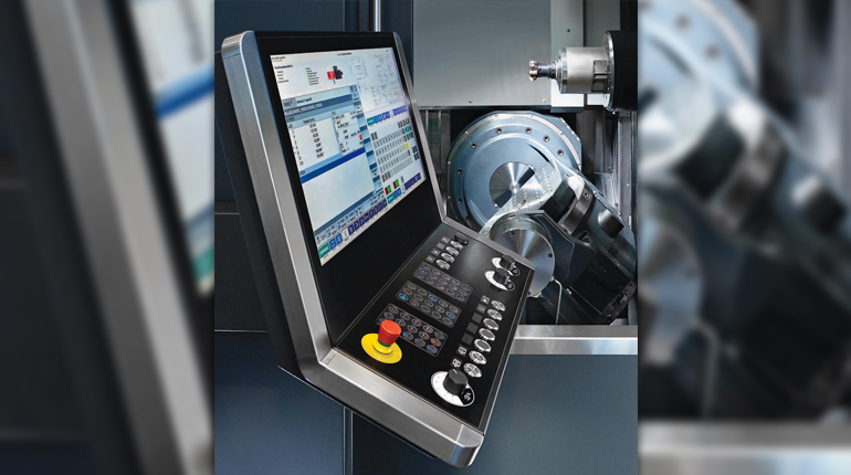

HF series machines are equipped with a Siemens Sinumerik 840D sl control and a double pivoting main operator panel with a 24-inch touch screen. A new operator interface compatible with Heller4Industry, quick access technology in the control and XTENDS optional expansion applications support the user. An work area camera is available to aid setting and monitoring functions.

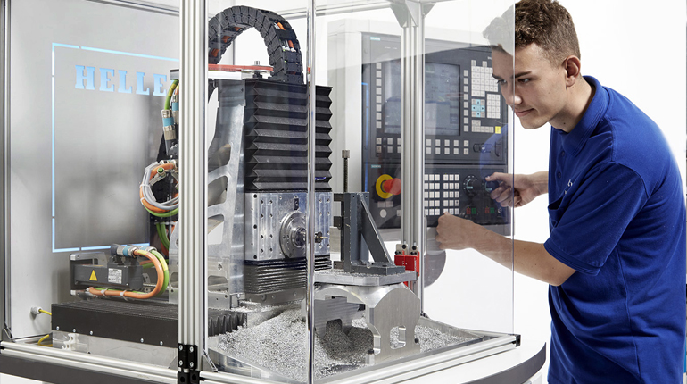

An advanced training machine designed to raise the skill level of horizontal machining centre operators away from the shop floor will be on show for the first time. Fitted with a new, Industry 4.0-compatible operator panel, the latest CNC ProfiTrainer builds on the capabilities of an existing 4-axis training machine with a rotary table by offering the option of an additional +30 / -120 degree A-axis.
The fully configured, functional machine, which is powered by a single-phase electrical supply, is likely to be of interest to industrial training establishments, colleges and schools, especially as it is small enough to be transported between different educational centres if necessary. Larger OEMs and subcontractors may also choose to adopt the machine for operator training. There is a rental option, with payments subtracted from the purchase price if a customer later opts to buy the machine.
The realistic simulator is fitted with a full version of the Siemens 840D sl control. Having 200 mm linear travels driven by servomotors at up to 15 m/min over linear rails, the machine is designed to mimic realistically the operation of a full-size Heller machine tool. However, it can also be used to provide training for any make of prismatic machining equipment in a safe environment.
The facility, which is designed to tolerate operating errors, provides skills training without tying up a machine on the shop floor, which would result in lost production. Furthermore, the risk of a crash occurring on a real machine is eliminated, avoiding potential repair costs. Another benefit of the training unit is that its small size encourages trainees to try out new things.
