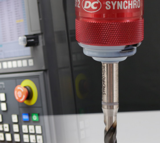

Let’s look more closely at one of the topics we’re asked about most frequently: Rigid Solid Tapping or Synchro Rigid tapping.  Different people use different descriptions.
Rigid tapping is when the machine tool programming controls the feed of the tapping cycle. This is the most commonly used method in today’s manufacturing sectors when it comes to producing internal threads on today’s modern machine tools for the most effective threading performance. This cycle holds the tap in a solid (rigid) holding method and uses the control system of the machine to rotate the tool and travel at a synchronised feed rate to cut the required pitch of the thread. Once at the correct depth the machine spindle comes to a complete stop, reverses the spindle (breaking the swarf on blind holes) and retracts from the component. All the stresses that this process creates are taken by the tap. Take a moment to consider a small tap in solid ER BT40 collet chuck asked to tap Stainless Steel with ZERO compensation at the point when it stops to reverse & break the chip at the same time – Is it any wonder the customer tells us ‘’ it tends to break at the bottom of the hole ! ‘’
Adding a synchro chuck instead of a solid holding method will greatly reduce the amount of stress that transfers up through the tap from the machine spindle at the point when it stops and reverses in a split second. These rigid tapping synchro chucks work in a similar way to the old tension and compression chucks but with only a minimal amount of ‘float’ that acts as a dampener for the tap. At the point when the tap reaches the bottom of the hole the minimal axial and radial float allow the tap to maintain perfect pitch synchronicity with the spindle – whilst completely removing all the stress on the tap.
The overriding success of rigid tapping cycles combined with synchro chucks is an improved tool life of 20% minimum, even where solid holding systems currently are working well. Synchro is immensely important when wanting to maximise cutting data, and particularly important in reducing tap breakage due to less pressure on the tap.  It is common sense that your tap will be cutting more sweetly without axial or radial pressure and so be more productive & safe.
So if you want to increase tool life, tool threading performance and be kinder to your machine, then Rigid Tapping Synchro is definitely something you should test us on.  Have a clear goal, don’t accept a problem, invite us to achieve your desired threading performance level & solve the problem.
