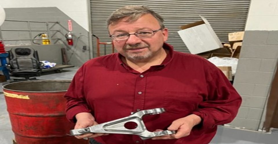

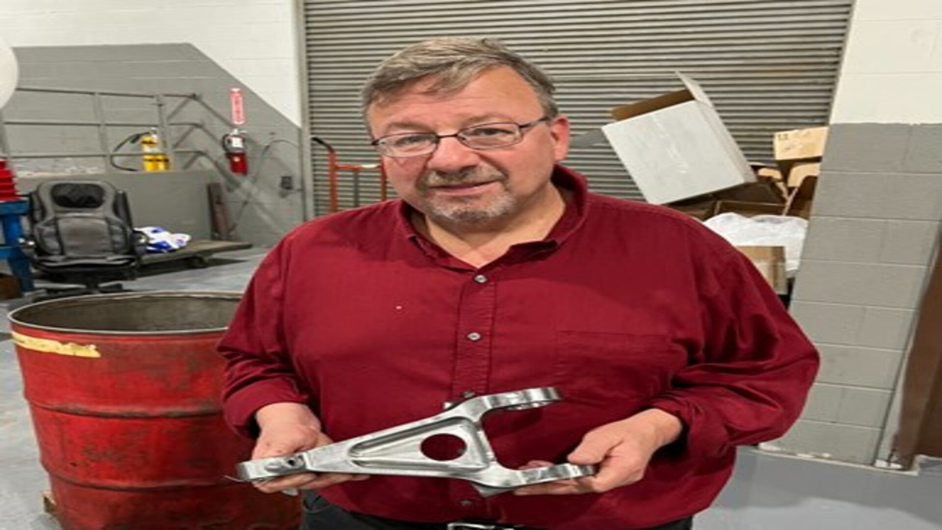

Whole-Hog to High-Speed Milling High-speed machining began replacing hog milling techniques in eight separate parts last year. The first was machining the forging of an F-35 torque arm, a regular item for the shop. Hog milling made wide cuts around the part but was a sluggish solution, whereas high-speed machining made tiny, considerably faster waterfall cuts.
When Flock initially started at Blair-HSM South, hog milling these torque arms took 20 hours. Since then, optimisations have reduced hog milling cycle times to around six hours. While this was an improvement, the shop still had backlogs during times of strong production demand.
Finally, Shop Foreman John Lent and Production Manager Josh Garrett started looking into high-feed machining processes as a possible option. Garrett conducted time analyses after Lent chose adequate tooling and discovered that high-speed machining may reduce cycle durations to between 30 and 40 minutes.
Using high-speed machining on one version of the torque arm saved 824 hours per year. On the other hand, switching from an expensive hog mill — and the regrinding processes required to keep it running — to milling inserts saved $11,500 in tooling per year. It saved roughly 101 working days for the entire portion family.
While not every part in the original part family had a major improvement in cycle time and tooling cost, all of the parts saw some improvement. As a result, expanding the usage of high-speed machining to other part families is one of the shop’s 2023 priorities.
