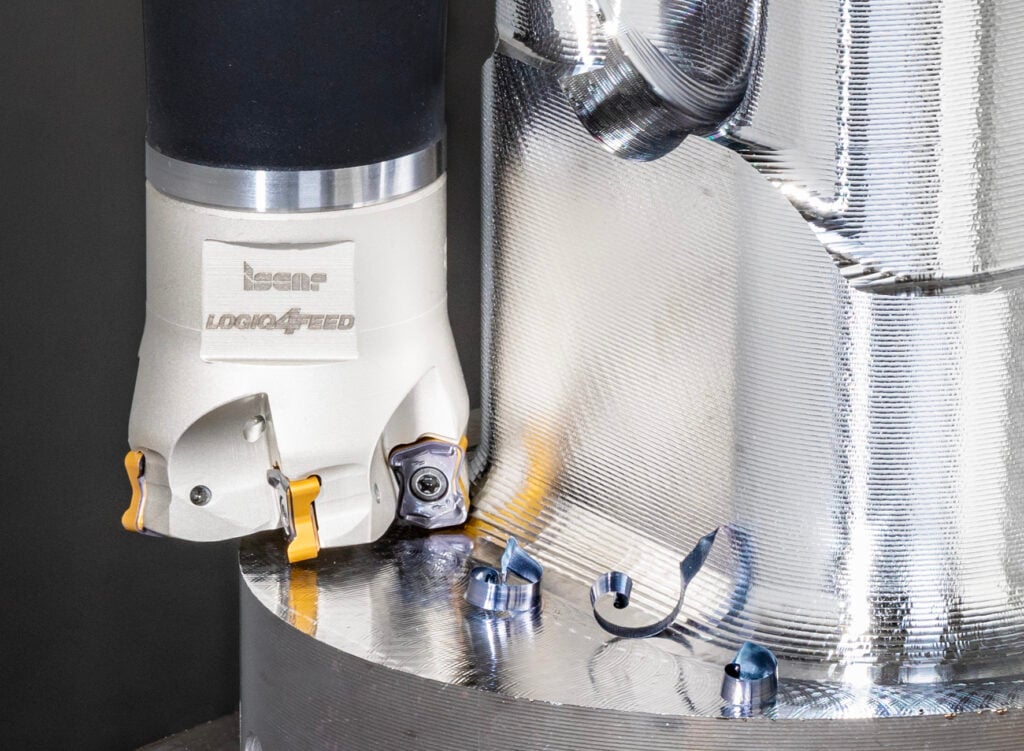

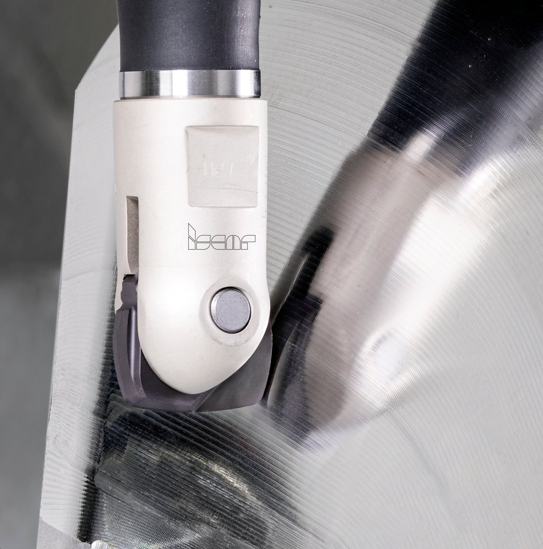

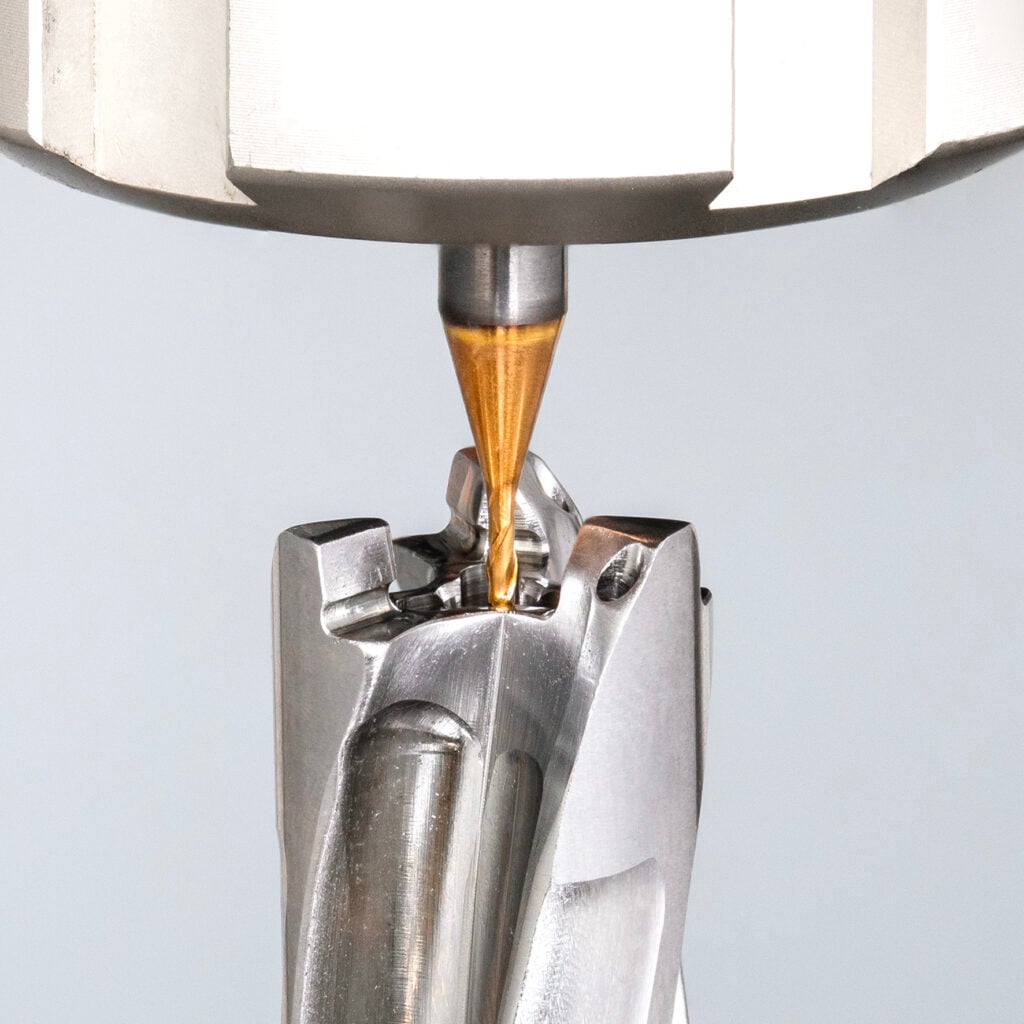

In indexable milling, ISCAR has expanded its line of HFM tools for machining hard materials. The popular MILL-4-FEED family now includes FFQ4 SOMW-T inserts, intended for milling workpieces with hardness up to 60HRc (Fig. 1). Meanwhile, the LOGIQ-4-FEED family, featuring bone-shaped inserts, offers solutions for machining materials with hardness of up to 49HRc (Fig. 2). Both lines are widely used for milling repaired surfaces of moulds and dies after welding and post-weld treatment. The NEOBARREL family of single insert endmills with barrel and lens cutting profiles is designed for semi-finishing and finishing complex 3D workpieces with hardness up to 62HRc (Fig. 3).
