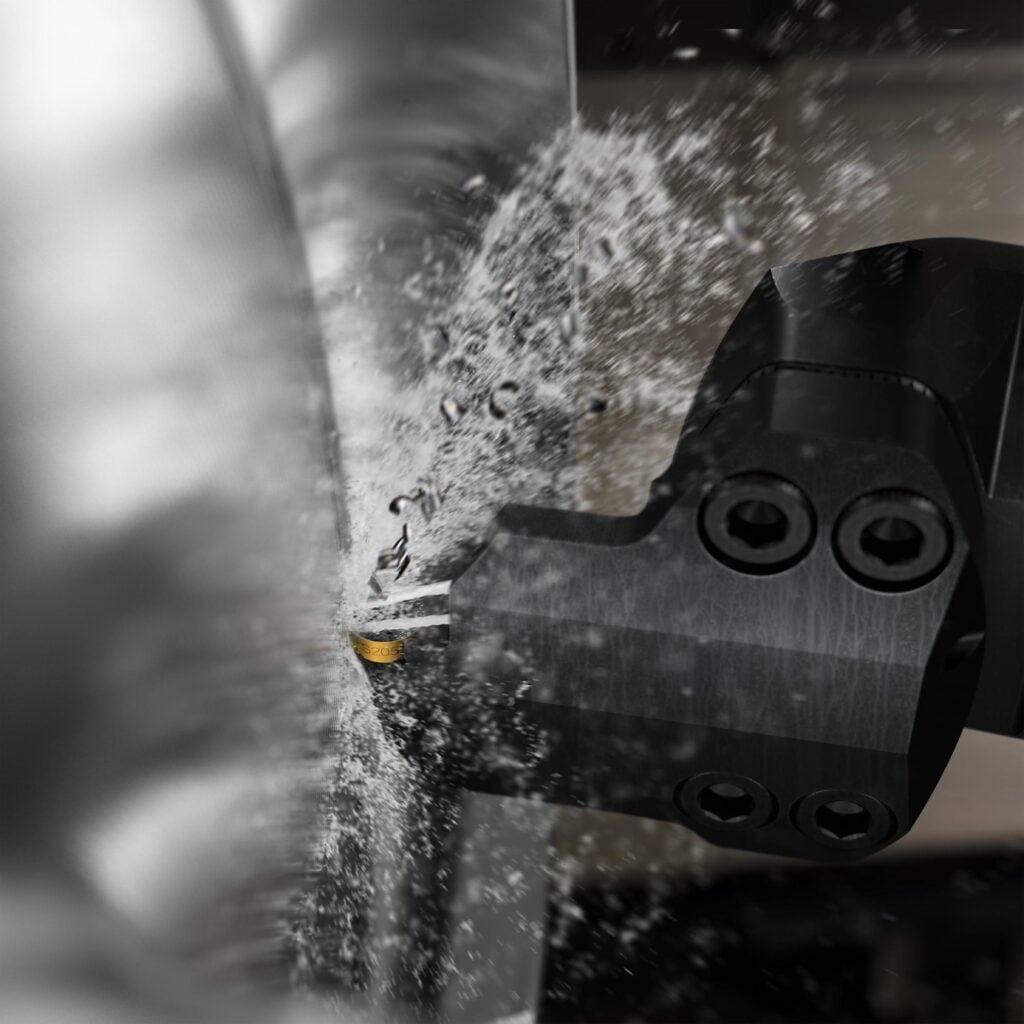

Machining high-temperature components
While lightweight materials dominate the cold section of modern engines, the hot section poses a distinct manufacturing challenge. As operating temperatures rise to improve thermodynamic efficiency, components such as turbine discs, blisks and rotating seals increasingly rely on HRSAs that maintain strength, creep resistance and structural stability at extreme temperatures.
Although alloys are crucial to future engine performance, their strength, hardness and low thermal conductivity make them significantly more difficult to machine. As heat concentrates in the cutting zone, tool wear accelerates, so finishing operations require exceptional stability to maintain tight tolerances on high-value parts.
To manage these pressures, manufacturers must adopt machining approaches that prioritise process security, heat control and predictable tool behaviour.
For example, Sandvik Coromant’s S205 chemical vapour deposition (CVD) grade was developed specifically for final-stage machining of superalloy components, where surface integrity is critical. Delivering 30% to 50% higher cutting speeds in semi-finishing and finishing applications, the grade offers increased productivity without compromising tolerances and surface conformity.
Secure toolholding systems also play a key role. Solutions such as the CoroTurn® 107 rail-interface holder provide stability during profiling and reduce the risk of insert movement on complex geometries. Combined with real-time monitoring and predictive techniques to track load, vibration and temperature throughout the cut, these strategies ensure that machining remains a vital enabler of the performance gains expected from tomorrow’s ultra-efficient engines.
