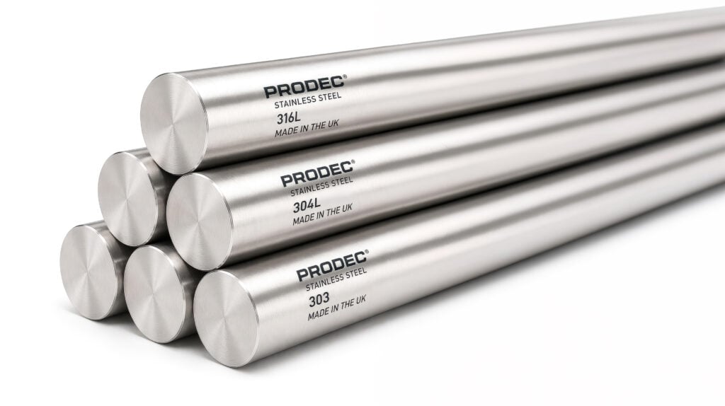

As part of the Langley Alloys group, Offshore Stainless & Alloys Ltd has partnered with Marcegaglia Sheffield to stock PRODEC® enhanced stainless bar across its full 316, 304 and 303 range. In a significant commitment to its customer base, all stainless round bar and cold drawn bar are now PRODEC® grade as standard – available direct from UK stock, with short lead times.
For UK CNC machinists and engineers who specify stainless bar, two things matter above almost everything else: reliable supply and total cost per machined part. Offshore Stainless & Alloys is now delivering on both.
The company, now part of the Langley Alloys group following its acquisition in early 2026, has become a dedicated UK stockholder of PRODEC® stainless bar in partnership with Marcegaglia Sheffield. Standard round bar is held from 10mm to 180mm in diameter; cold-drawn bar from 7.925mm to 100mm. Importantly, this is not a parallel offering – 316, 304 and 303 supplied by Offshore Stainless & Alloys, in both product forms, are PRODEC® grade as standard.
