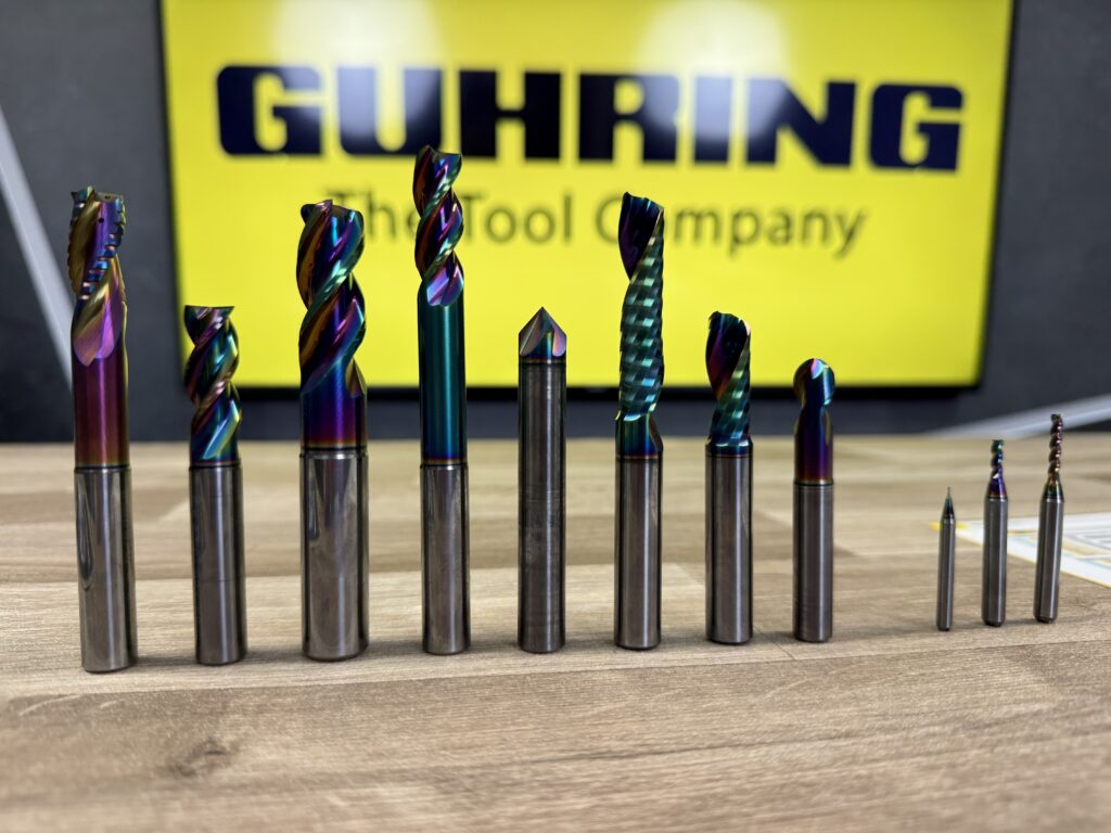

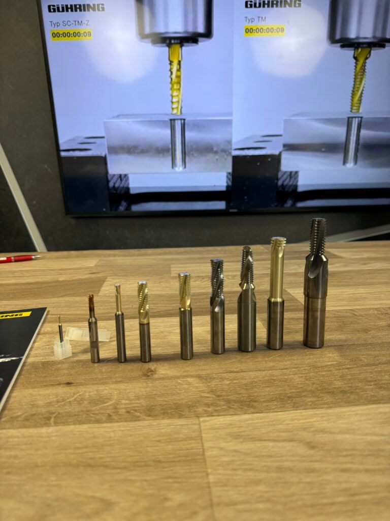

“The regrind service covers almost any tool with a cutting edge. We can regrind gun drills, normal twist drills, thread mills, end mills, and we can re-tip PCD tools as well.” The PCD re-tipping work is a reminder that high-value tooling is exactly where the savings bite hardest.
