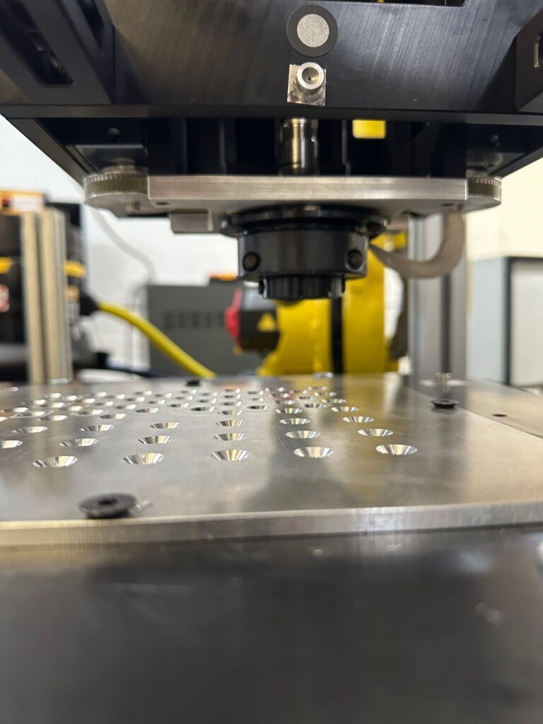

To understand TPR’s proposition, it is necessary to understand the scale of the problem it was created to solve. Drilling, countersinking, and inspecting aerostructure parts are among the most demanding and labour-intensive processes in advanced manufacturing. A single aircraft panel contains thousands of holes, each machined and validated to tolerances of between 100 and 300 microns. Done manually, this requires teams of skilled operators working across multiple shifts, consumes enormous time, and carries a persistent risk of rework and quality challenges, all of which add cost and delays to delivery.

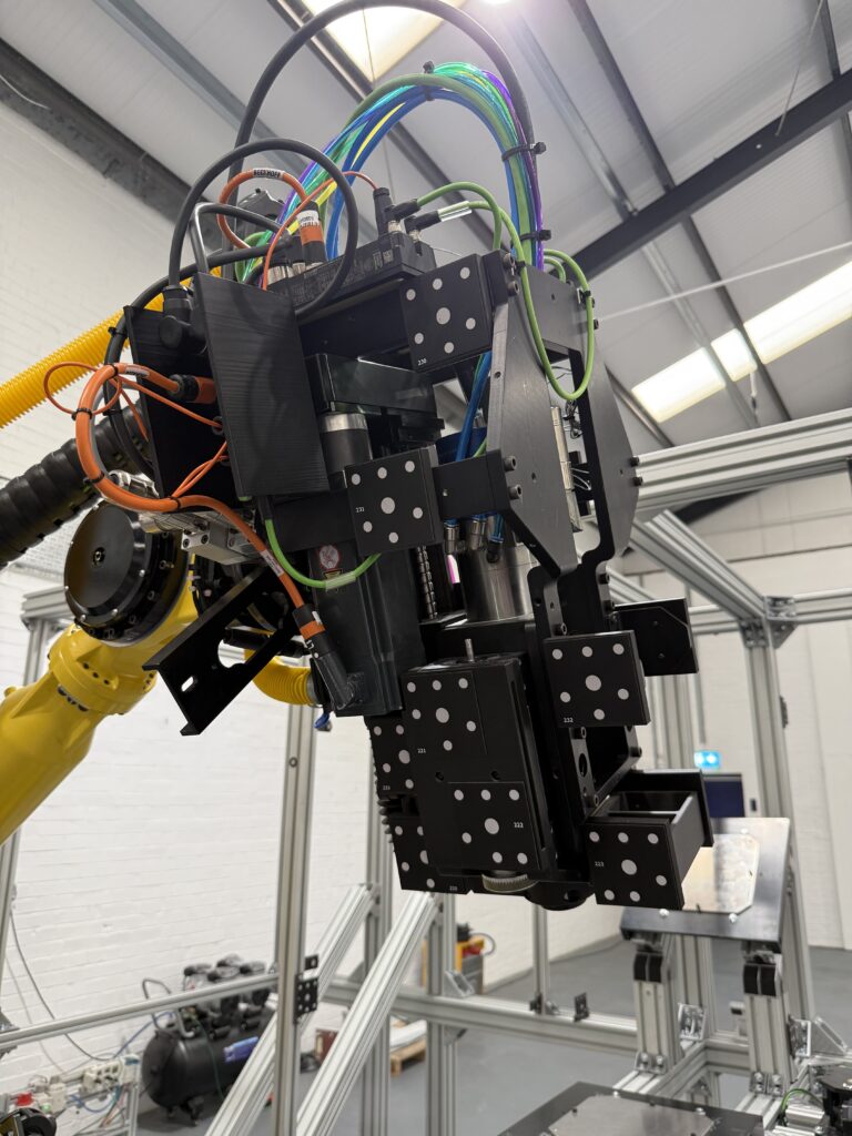

TPR’s ADI system addresses four interconnected challenges. The first is accuracy. Standard industrial robots achieve positional tolerances from 1 to 15mm, far short of the 100 to 300microns required for aerostructure assembly. TPR’s patented ARC+ guidance platform incorporates large-volume real-time metrology, machine learning, and digital thread integration to deliver a consistent mean accuracy of 0.05mm with a radial tolerance of 0.2mm and a CpK of 2.91. These figures meet or exceed the most demanding aerospace design book tolerances.

Flexibility is also integral. The ADI system integrates with existing customer software environments — including Catia, Siemens NX, and Polyworks — without requiring a wholesale change to established digital infrastructure. It supports multiple end effectors within a single cell, enabling drilling, countersinking, adhesive application, and riveting to be performed in sequence with automatic tool changes. Its large-volume metrology system scales to the application, from a single camera covering three cubic metres to multi-camera configurations for assemblies exceeding 30 cubic metres. For manufacturers where part size or complexity makes fixed-cell automation impractical, TPR’s platform supports fully mobile deployment via AGV or AMR, with the robot moving around the part rather than the part being transported to the machine.
