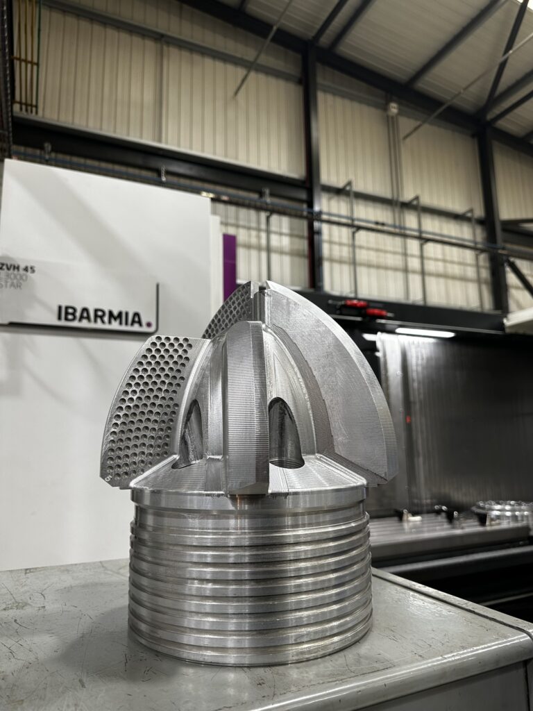

Cutting and Wear Resistant Developments Ltd, a leading manufacturer of specialised downhole tools for the oil and gas industry, has undergone a transformative shift in its production capabilities after investing in an Ibarmia machine from Dugard. The company, led by Managing Director Matthew Cooper, has followed a successful growth trajectory over the past 12 years, and the introduction of this advanced CNC machine has played a pivotal role in supporting its expansion.
Cutting and Wear’s unique selling proposition lies in its ability to manufacture tools with a hard-facing aspect and integrate innovative machining processes to deliver comprehensive solutions for its customers. Prior to the arrival of the Ibarmia ZVH 45 L3000 machine, the company encountered challenges related to the complexity of its tools, lead time constraints, and the efficiency of its manufacturing methods. However, the implementation of the new machine has revolutionised their operations.
“In the 12 years I’ve been here, I’ve seen many changes, both in the company and the industry, but pleasingly, we’ve adhered to a successful growth plan, leading us to where we are today—continuing that growth and progressing in the right direction with new machine investments,” explains Matthew. The Ibarmia machine, equipped with a high-performance spindle capable of reaching speeds of up to 12,000rpm, has enabled Cutting and Wear to reduce lead times and machining times significantly.
Mark Taylor, a CNC Programmer at Cutting and Wear Ltd., highlights a remarkable example: “We had one tool that previously took us 11 hours to mill; on the new machine, it was reduced to just two hours.” That’s a massive improvement for us.” One of the standout features of the Ibarmia machine is its advanced probing capabilities. By integrating probing into the machine’s programming cycle, Cutting and Wear have eliminated the need for manual programming, further streamlining the manufacturing process. As Mark explains: “We can execute everything on the machine as it’s built into the programme, so there’s no need to remove it from the machine for inspection, and that’s a time saver as well.”

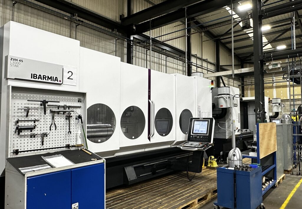

The Ibarmia ZVH 45 L3000 machine from Dugard is a 5-axis travelling column machine with an X, Y and Z axis travel of 3m by 1.2m by 800mm with a B-axis head range of +/-105 degrees. Supplied with an SK40 head as standard or HSK A-63 as an option, the ZVH 45 has a powerful 45kW spindle with 200Nm of torque. Provided with a FANUC or Heidenhain TNC control, the ZVH 45 L3000 is available with a multitude of options to maximise productivity for the end user.

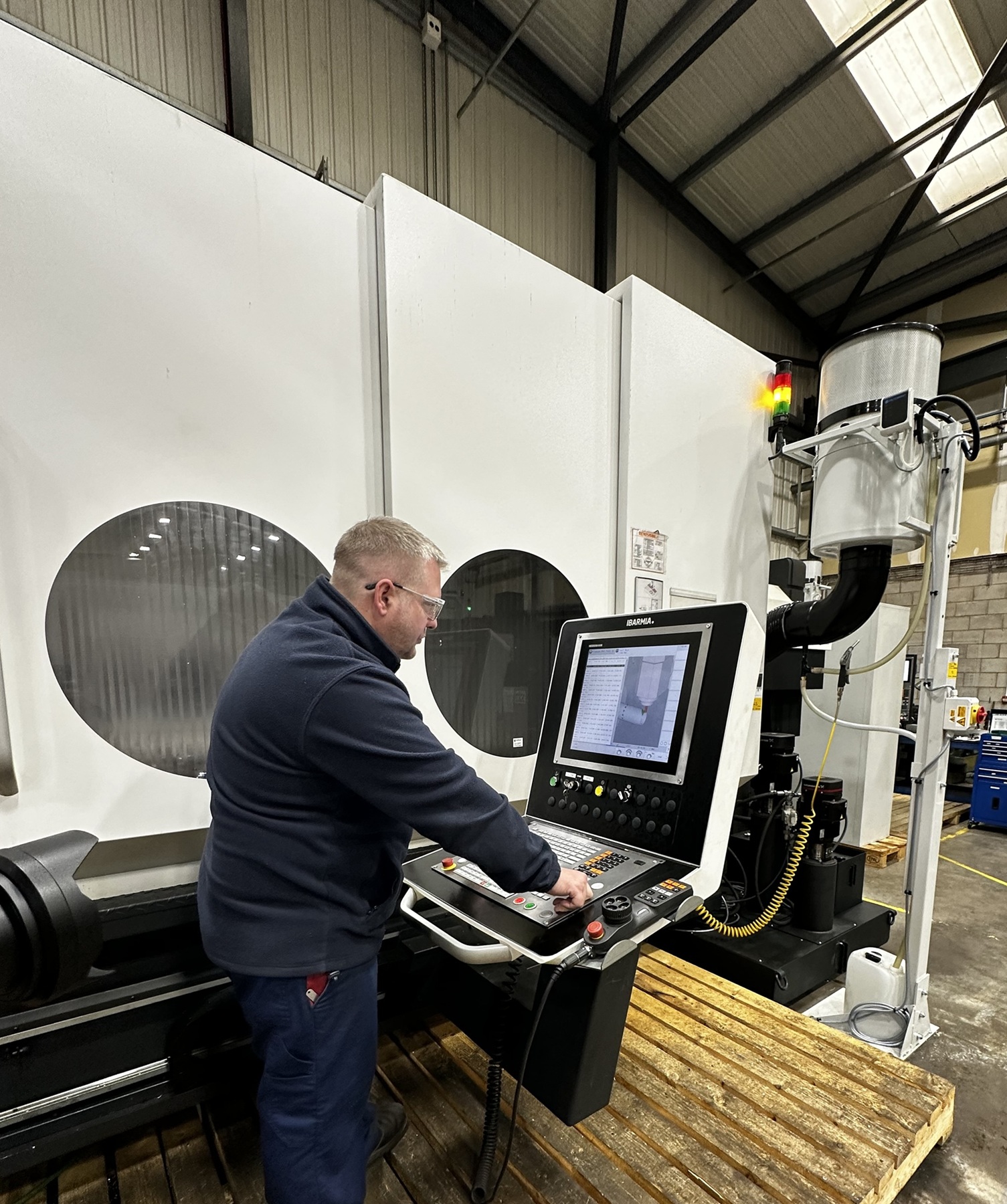

The machine’s state-of-the-art graphics function has also significantly enhanced the programming experience. Mark notes that approximately 90% of the programming is now done offline, with the remaining 10% proven on the machine. “The graphics have been tremendously improved on these machines. A lot of the programming, I’d say 90%, is done through offline programming, and then we have to prove it out here, but with the graphics function on this machine, it just makes everything so much easier and reduces errors,” he says.
