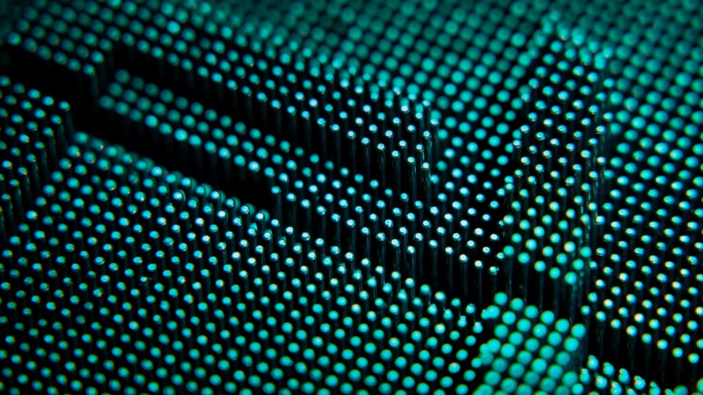

Orthotics are externally applied devices used to influence the body’s function. They can be applied across the body but are most used to support the feet and lower legs. Foot orthotics are custom-made supports for the patient. Here, conventional mould tools used to make a plastic mould are uneconomic—short-run batches don’t cover the tool cost.
Fyous, the Sheffield-based polymorphic moulding technology provider, uses a proprietary pin tool with 28,000 pins to create a customised, ‘shapeshifting’ mould in around 20 minutes. It recently partnered with Peacocks Medical Group, the UK’s largest independent orthotics company, to use the polymorphic technology for its products.
“This collaboration shows how polymorphic moulding can help the production of lasts (foot orthotics), cutting waste and costs, and improving efficiency,” said Joshua Shires, CEO and Co-Founder of Fyous. “Early adopters like Peacocks will gain a competitive edge as the industry moves towards more sustainable, digital-first manufacturing.” Fyous is now developing its pin technology to address the diabetic foot care market, where the NHS spends nearly £1bn a year on diabetic care.

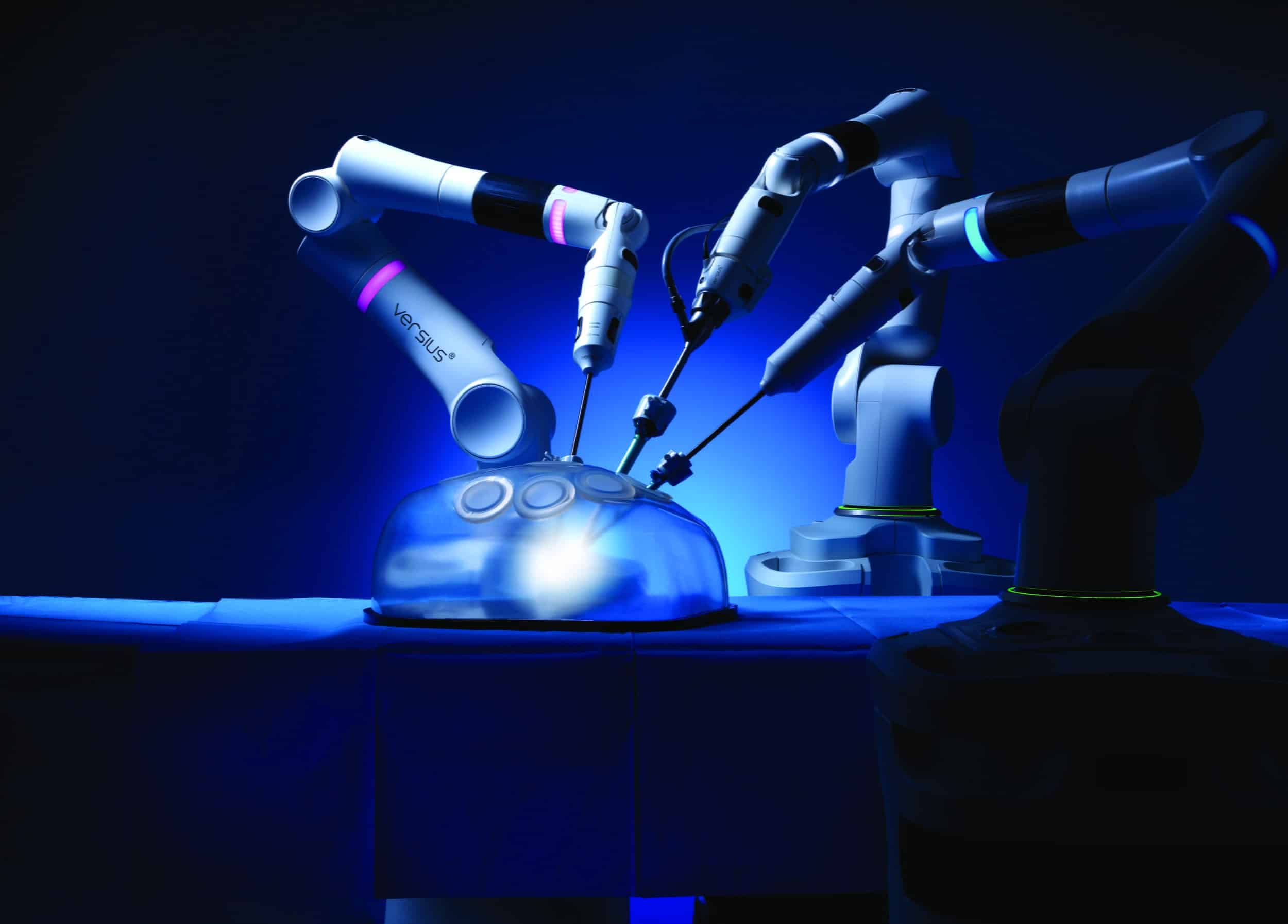

Several British MedTech companies are attracting big investments. In April, Cambridge-based robotics company CMR Surgical closed a US$200m funding round with a mix of equity and debt capital from investors Trinity Capital. The funds will be used to expand CMR’s flagship Versius Surgical Robotic System to more hospitals globally, with a focus on the US market, and to support the launch of the enhanced Versius Plus. In 2021, CMR’s private funding pushed above £1bn, valuing the company at $3bn.
“We are now at a pivotal stage, poised to capitalise on significant opportunities for market expansion, including in the U.S, while penetrating deeper into expanding markets,” says CEO Massimiliano Colella.
