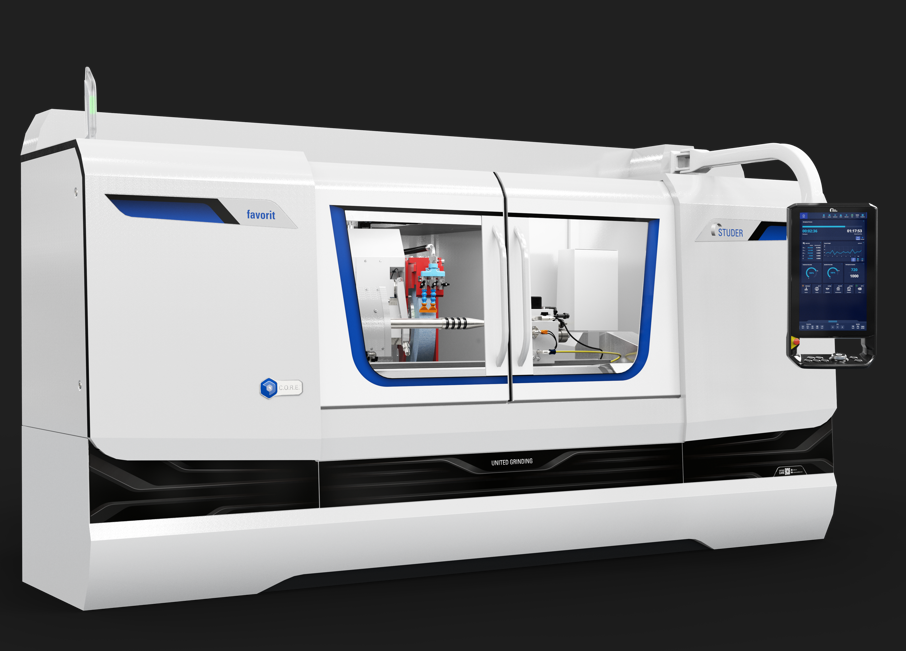

At the heart of Studer’s 2024 innovations was the advanced favoritCNC universal cylindrical grinding machine, representing a significant leap in grinding technology. The machine integrates the latest FANUC 0i-TFP control system with a sophisticated engineering approach that demonstrates the company’s commitment to precision and user accessibility.
Technical specifications reveal a meticulously designed piece of equipment. The machine offers flexible wheelhead configurations, including a fixed wheelhead with manual positioning at 0°, 15°, and 30° and a universal wheelhead with a 2.5° Hirth coupling for seamless internal and external grinding capabilities. Its foundation is constructed from Granitan® S103 mineral casting, a proprietary material that provides exceptional thermal stability and vibration damping.
The machine’s physical capabilities are equally impressive. It can accommodate centre distances of 650mm or 1m, handle workpiece weights between 80 and 120kg, and accept grinding wheels up to 500mm in diameter. Perhaps most innovative is the machine’s intuitive StuderPictogramming and StuderGRIND grinding software, which provide modern digital solutions that allow even complex grinding processes to be set up and controlled intuitively.
