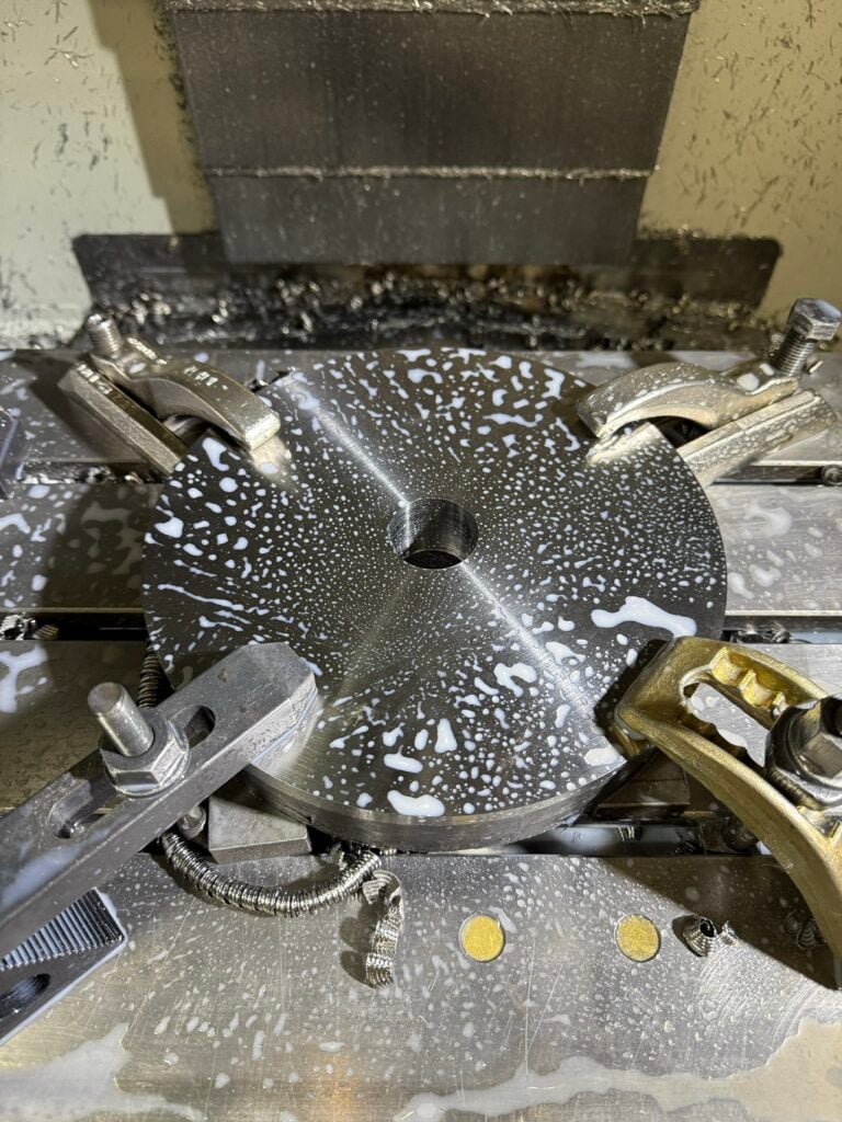

The centrepiece of RCAS’s 2025-26 innovation entry is a proposal to machine locomotive wheels from billets produced using Field Assisted Sintering Technology (FAST) — a process that consolidates titanium machining swarf into a solid, usable material under electrical current and pressure, closing the loop on material that would otherwise require energy-intensive re-melting. The innovation targets a weight saving of around 30kg per bogie compared with conventional steel wheel sets, delivering significant benefits for unsprung mass, dynamic performance and the railway industry’s long-term sustainability goals.
Machining the wheels demanded a full sequence of titanium machining, from facing, OD turning, deep-hole drilling, precision boring for the taper-lock interface with the axle, pocket milling and final flange turning. Without the right tooling, the university’s in-house machinist estimated that consumable costs alone could reach £5,000 — nearly a fifth of the team’s entire £29,000 annual budget.

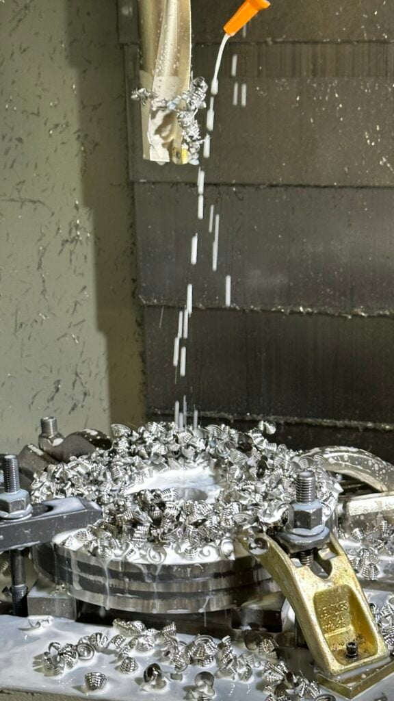

With the grade settled, Stephen specified a compact suite of tools matched to the operations and the machines available. Face milling and pocketing were handled by two CERATIZIT Coreline A251 shell mills. One was a 52mm diameter tool body carrying five MaxiMill RPHX inserts, and the other was a 42mm diameter body running the smaller button-style RPHX inserts, both loaded with the CTC5240 grade inserts. The critical entry bore for the taper-lock interface, along with the deep-hole drilling, was opened by a 4XD 40mm indexable KUB Pentron drill with through-coolant and SOGX inserts. This paved the way for a boring bar to follow and bring the bore to its finished diameter.
The OD turning and facing were carried out using a Coreline lever-clamp turning holder with CNMG inserts, while two 16mm, four-flute solid carbide MonsterMill end mills with a 3mm corner radius completed the package for profiling and finishing work.

The Pentron drill provided an early test of how CERATIZIT’s tooling would perform in a university environment. As the wheelsets for the project were not on a strict deadline, the capable XYZ machines ran the 40mm drills with the programmed feed rate halved as a precaution. “It got through the wheels in seconds with no issues. The inserts looked like they hadn’t even been used. It was incredible,” says Oscar.
