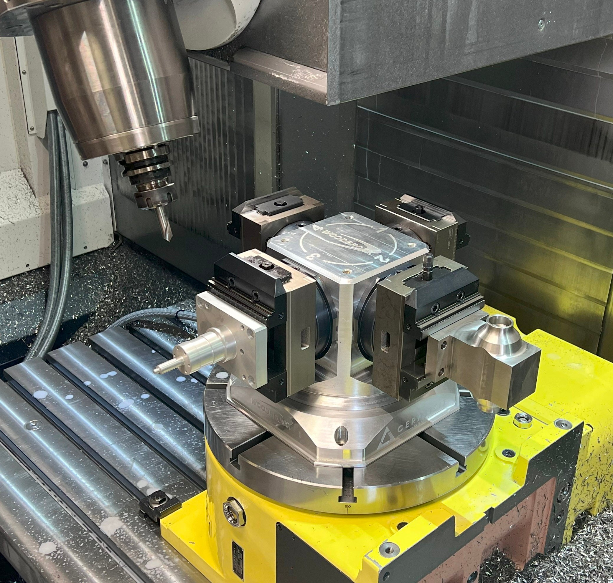

With the 100-off stainless job running through the business frequently, Woodbrook set up six vices in a line on the spacious 3.5m bed of its Mazak 5-axis VTC800/30SR.
When each surface and cycle was completed, an operator would re-set the job to process the next face.
With a total of four operations, the process was laborious.
Stephen spoke with Matt from CERATIZIT, and the way forward was a bespoke workholding solution that was ‘Made in Sheffield’ at the CERATIZIT UK Technical Centre and Headquarters.
Stephen visited the CERATIZIT stand at MACH 2024.
He realised that the only cost for CERATIZIT’s bespoke service was the price of the aluminium tombstone billet and the cost of the four ZSG4-125 Centric vices that connect to the zero-point single riser tombstone system.
Immediately impressed, Woodbrook Precision ordered a pyramid system to clamp smaller parts in its 5-axis Mazak CV5-500.
The ZSG4-125 Centric vices with serrated jaws enabled Woodbrook to clamp on as little as 3mm of stock, permitting the subcontractor to hit all five sides of the stainless parts with confidence in the high-torque clamping forces of the vice.
With five faces machined in a single operation, the following operation was to turn the parts over to complete the sixth surface.
This reduced this 100-off repeat job from a four to a two-operation process, saving an additional 10 minutes per part.
Stephen says: “This job took over one hour per part from start to finish.
The tombstone and Centric ZSG vices immediately took more than 10 minutes off each part, with peripheral savings being longer running times without operator intervention.
Reduced set-ups also improved our precision, repeatability and consistency over an entire batch of parts.
We work 12 hours a day, six days a week, and the tombstone enabled us to set up a batch of four parts at the end of a shift to run unmanned for a couple of hours – giving us further savings.”
