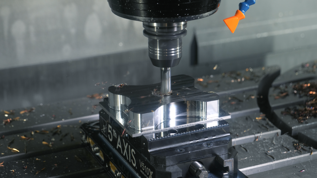

Programmed in Fusion 360 from MSC’s published cutting data and deliberately running dry so the camera could see the swarf, Tom started cautiously. “I just want to make this crystal clear before we start, for 90% of this program – I’m not using coolant. If I were doing this in a work environment, I’d be using coolant. But if I use coolant, we won’t see anything.”
The 16mm 4-flute end mill was immediately put into service as a face mill because none is currently in the EDGE line-up. It settled in after a 10% increase in spindle speed to remove a touch of vibration on the heaviest pass. The reaction was immediate. “That sounds really nice.” While helical-interpolating into a pocket, Tom was clearly surprised: “Oh great, it’s silent. You can hardly hear it. I think another 10% on the spindle will make that even quieter. This is actually H13, so it’s not just any mild steel.”
Chip control drew the same excited response. “The chips are coming off a nice golden colour. That’s coming off beautiful, absolutely golden. I’ve used a lot of end mills in my time that would not have done that; they would have really struggled with that cut. It’s quite a small pocket and quite a big end mill, but the chip evacuation is beautiful.”
Dropping in the 10mm flat bottom end mill to finish the top face at a 75% step-over, Tom was happy with the surface left behind. “I’ll take that finish. That’s not bad, is it? And that’s been done with an end mill. There are no tool marks. You can’t feel any tool marks between the passes, which is always good.” Kasra’s one-line verdict on the first part, run from end to end on book data and dry: “A thing of beauty.”

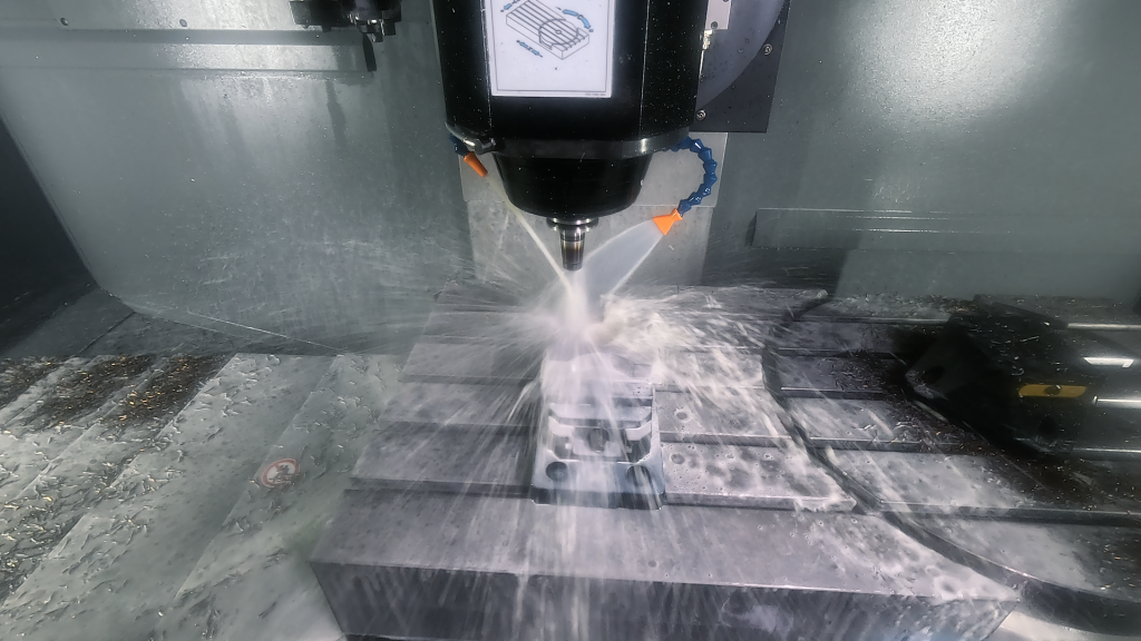

For the second part, Tom kept the same tools but increased the surface speed and chip load by two times on the program. After running it for a few seconds, Tom incrementally climbed in steps, firstly running +10%, then +15%, then up to 125% feed – before settling on 150% feed rate and 150% spindle speed increases, the limit of the Hurco’s manual override. “Three times faster than the book data. That’s pulling a bit of spindle load now, though. It’s at 18% spindle load, and that’s doing 15% step-over, but 125% on the feed.” Kasra, watching the swarf, said: “On H13, cutting dry with a 16mm cutter, that’s impressive.”
Even at full cut, long, golden chips were streaming out of the pocket. “Look at the colour, absolutely golden. That’s where I think it sits right, because they come out gold and they turn purple when they hit the bed.” Kasra adds: “Well, that’s what you want – heat in the swarf and not in the part, and not in the cutter.”
The variable-pitch, variable-helix geometry kept chip evacuation clean even when Tom pushed harder again. “It’s like that bubbling effect. It’s getting all the swarf out, which means it’s not recutting its own chips.” Kasra confirmed the design intent: “That’s the pitch we’ve designed into the tool. It’s evacuating the swarf – especially when you go into a deep pocket.”
By the time Tom was finishing pockets with the same end mill that had been roughing them, the override was pegged at 150% / 150%. “We can’t physically go any further on this machine. The machine is maxed out on override controls, and I still think there’s more to give in that tool.”

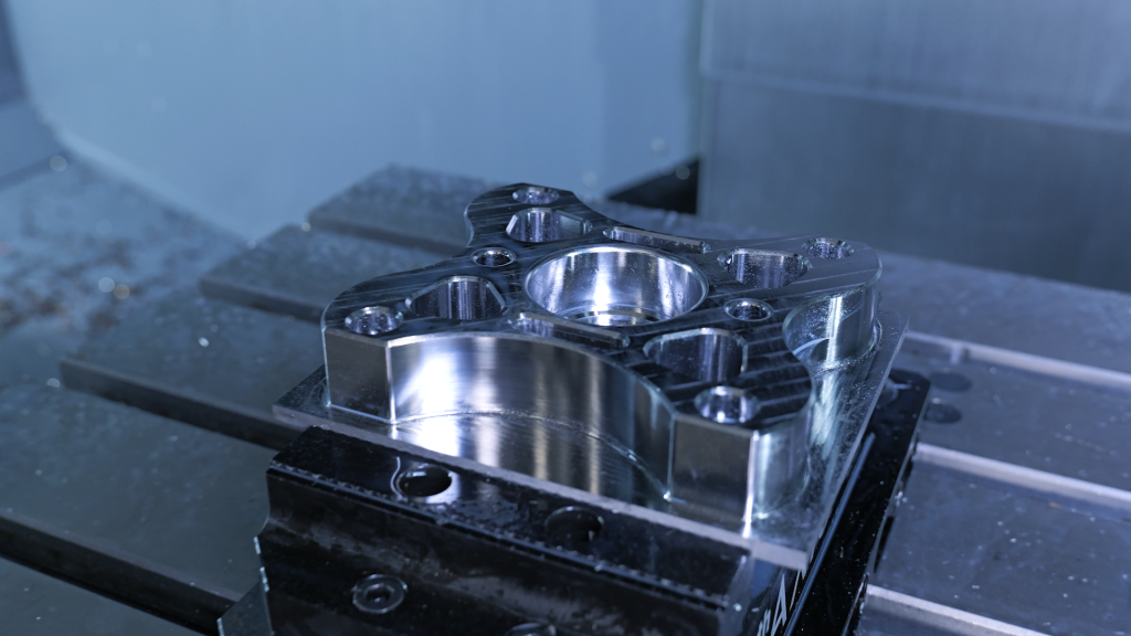

Side-by-side, the two parts – one cut on MSC’s published data, and the other one cut with the Hurco’s overrides at the limit – were indistinguishable. “To be honest, they look identical to me. They absolutely look identical,” Tom said. “Even if you look at the finish, there’s no difference.”
For Tom, the standout point was that the same 16mm 4-flute end mill had roughed the pockets, finished the outside walls, and faced the top of the part. “I’ve used the same tool to rough the pockets and also finish the outside. You’d get quite a lot of people using a roughing cutter and a finishing cutter. I’ve been able to bring that down to one tool, and I don’t think you can complain.” Kasra says: “That’s the whole mindset – it’s about doing more with fewer tools. It’s the 80/20 rule. You want to do more roughing and finishing with the same tool that’s already in the carousel. It reduces tool changes.”
