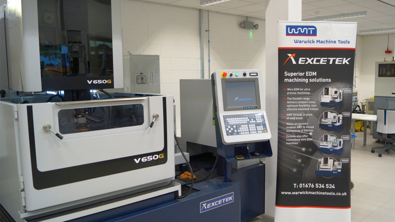

“Once a printed metal part has been generated it has to be removed from the base plate used in the machine. To efficiently achieve this, we have recently invested in an Excetek CNC wire EDM machine that meets our needs.”

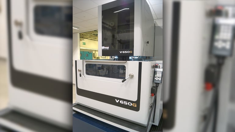

The new Excetek V650 CNC wire cut EDM machine sits in the ultramodern, clean, well-lit workshop. Designed to match the ideal workshop specification, the standard V650G has axis travels of 650 mm in X, 400 mm in Y and 350 mm in Z, accommodating workpieces up to 1,000 x 700 x 345 mm and weighing up to 800 kg. With U and V axis travels of 160 mm and +/- 33o maximum taper capability, the V650G also has a positioning system of 0.0001 mm resolution.

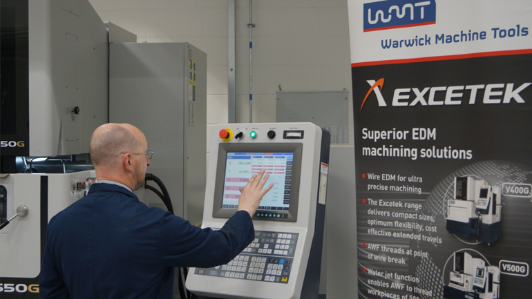

With an advanced NC controller and automatic wire rethreading at the point of break, the new machine supports unmanned overnight operations. It replaced an older wire cut EDM that never really delivered as Iain Lyall explains: “We struggled with the old machine, the unused powder from the additive process would drop down inside and cause havoc with the wire cut path. We spent a lot of time finding this machine and it took a while to get the right settings, which we did with the full help of the supplier.”
He continues: “We now have a phenomenal turnaround from a CAD file to a post-EDM part. We run all the EOS 3D printers and the Excetek machine overnight as they are setup during the day. From a student’s viewpoint, the scale of Excetek machine could be intimidating, but it is very straightforward to setup and the shapes and the details you can achieve are just something else. It also helps to build the students’ confidence as well, for when they go out into industry.”

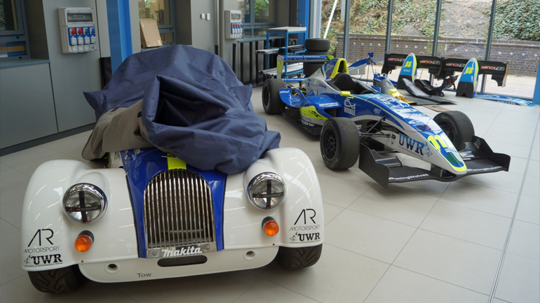

One of the strongest disciplines at the faculty is motorsport, with the race team based at the new facility. “It covers many different aspects,” says Iain Lyall. “We have around 30 students on the motorsport degree actively involved with the race car. Our message is that you can only learn so much in the classroom and the rest comes with experience. As for the bespoke engineered parts, due to the race series regulations we can’t put much on our F3 car, but our student car has a whole tranche of performance parts made and fitted. We are now also making parts for other universities because we have the facilities and equipment to make the parts and they don’t.”
