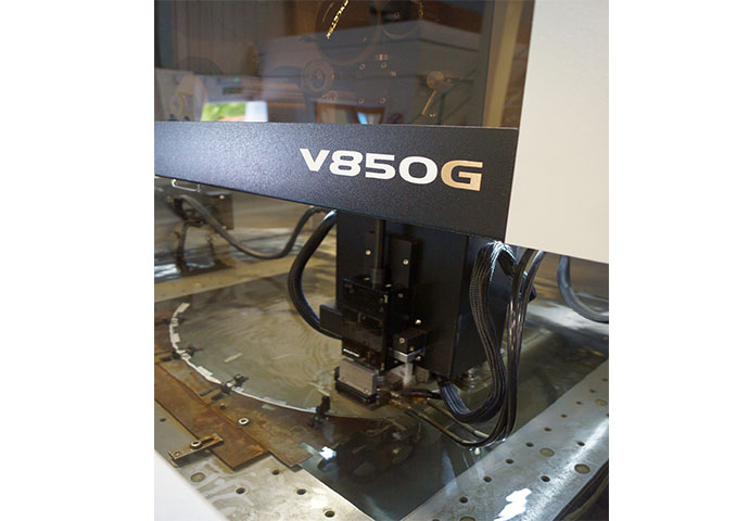

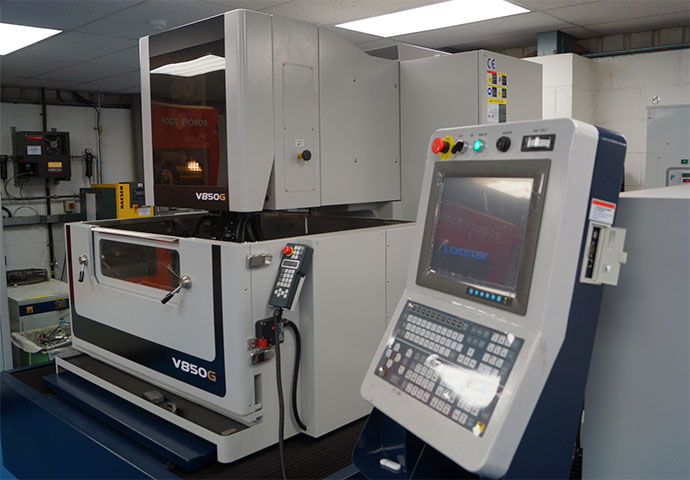

To meet the component sizes and capacity forecast Electro-Discharge ordered two Excetek V850G CNC wire EDM machines. The large capacity 1,000 litre submerged tank of the V850G is able to take workpieces weighing up to 1,100 kg and measuring up to 1,100 x 850 x 345 mm. Standard axis travels are generous at 800 mm in X, 500 mm in Y and 350 mm in Z, although a larger vertical Z axis can be specified.
Like all the machines in the popular ‘V’ range the V850G features a C-frame structure designed using FEA software to provide exceptional accuracy in the linear axes movements and to minimise any thermal influence. The AC servo motor driven C1 class ball screws are cryogenically treated to minimise the thermal effects of the machine’s ambient operational environment, with high accuracy linear scales fitted for positional feedback.
A key feature for Electro-Discharge’s extended operational hours is the automatic wire feed and threading (AWT) system. Designed to provide continuous unmanned operation around-the-clock, the AWT offers the ability to thread the wire at the point of the breakage. An automated annealing system straightens the wire so that it can be threaded at the break point during machining with almost 100 per cent reliability and without the need to return to the start position. Submerged wire threading is possible, which removes the need to drain and refill the tank. A water jet assist system is available for automatic wire feeds on tall workpiece.
Other optional extras that can be specified for increased machine operating efficiency include remote monitoring via ethernet or internet and Short Message Service (SMS), which will automatically send an alarm message to a mobile phone if the machine stops cutting. For extended operation a 50 kg jumbo wire feeder can also be fitted.
Excetek leave nothing to chance and even the CNC system has been developed in-house, using Windows-based XP-E 64-bit architecture with a 15 inch LCD touch-screen for programming. Excetek says it is easier for operators to understand as they are already familiar with the ‘look and feel’ of the Windows environment. It cuts down the training time required, so one day’s training is all that is required before the operator is competent to program and run the machine. Programming can be done using standard ISO G code or Excetek’s Icon Assistant conversational software, which uses the controls extensive database of cutting technologies.
The control system can also apply offsets to allow for any misalignment during workpiece loading. Before machining an edge finding operation sets the actual position of the raw material, and the control software resets its datum points accordingly.
A new design EF (AC) Electrolysis Free generator system provides improved cutting speeds that are around 10 per cent faster, a maximum cutting speed of 300 mm2/min can be achieved with 0.3 mm diameter zinc coating wire and the optional Excetek high speed cutting circuit. The generator also supports Super Finishing techniques using high frequency technologies on surface finish cutting so a roughness of less than 0.2 micron Ra can be obtained with one cut and four skims.
