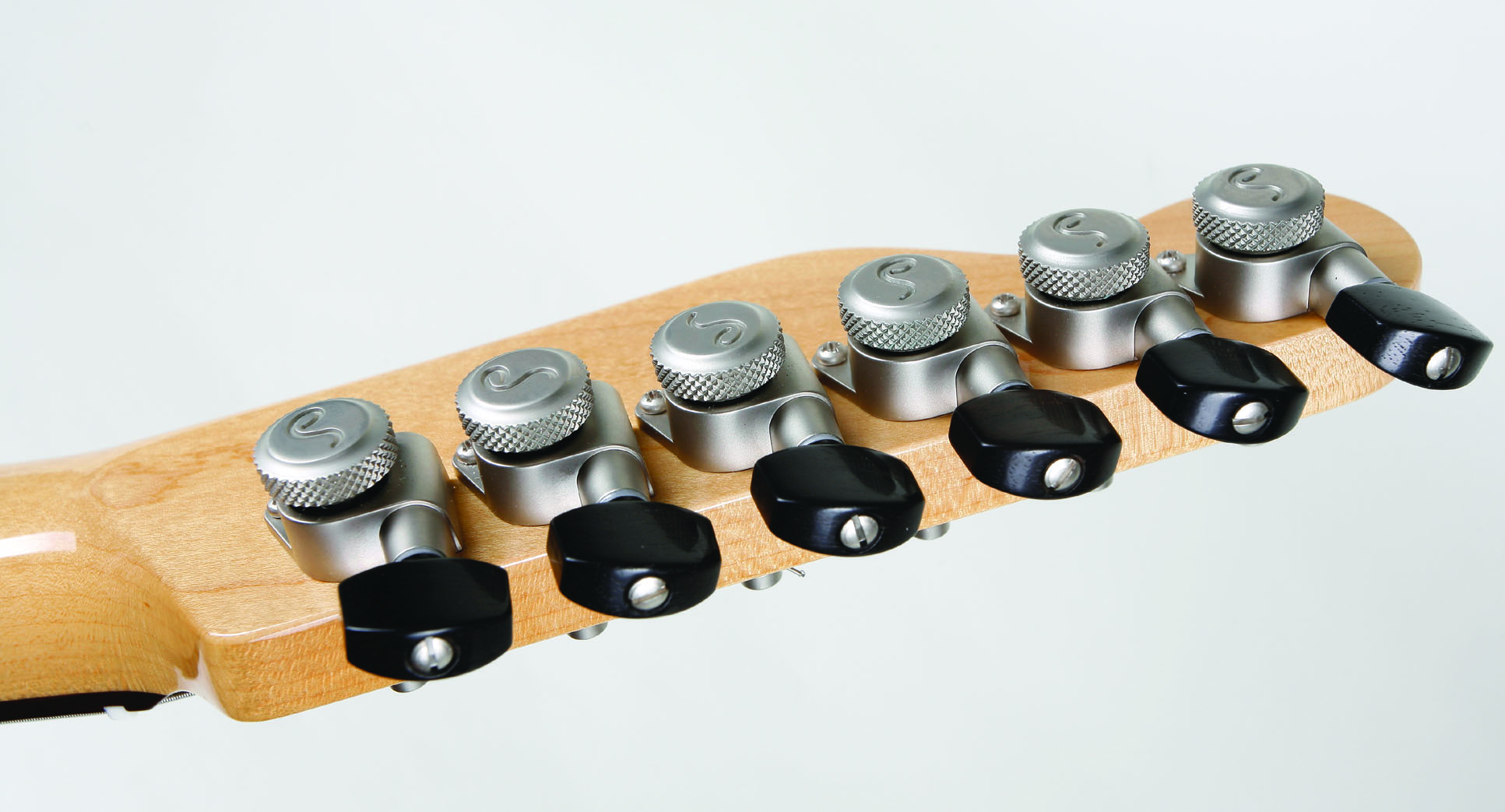

The strap button is turned in one piece and can be mounted most easily using a 3mm Allen key. The lock consists of a re-designed pin made of stainless steel and has a longer thread for thicker guitar straps. The lock wheel impresses with a 3-level security concept. The special patent-registered thread guarantees a safe grip and can be tightened and controlled even without using a tool. A 2-hole mount for 2mm Allen key or screw driver enables an even tighter grip. A slotted set screw with flat point (2.5 x 5 mm) made of stainless steel makes sure the connection can be easily loosened. The characteristic feature of this innovation is absolute silence. The three components mesh with such a precision that there is absolutely no chattering noise.
