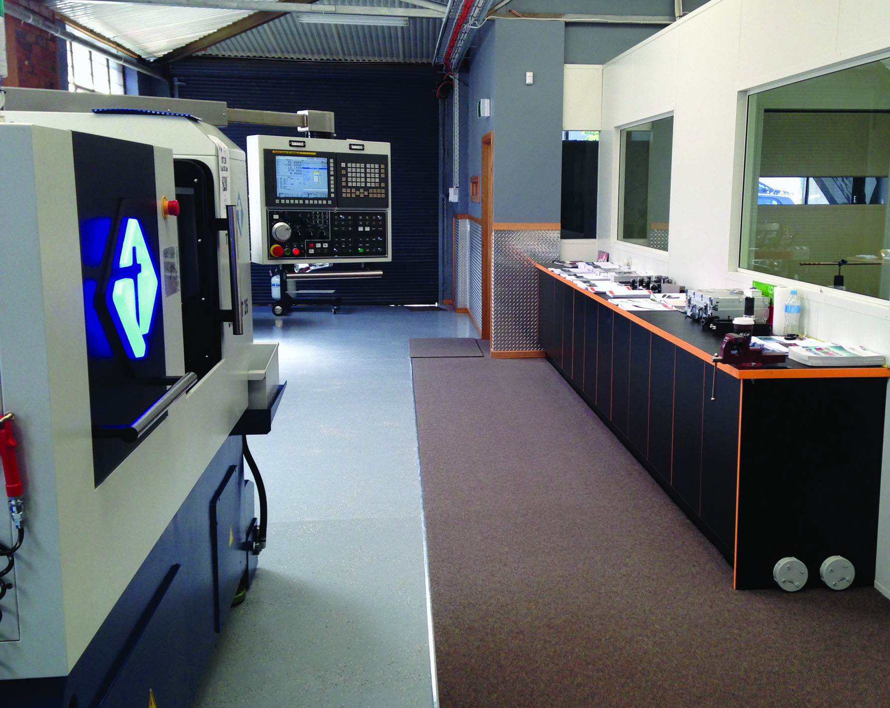

Before too long, Hart saw that Tornos’ Swiss-type technology opened up a whole world of possibilities. Even running the Delta 20 all day, they were limited in the parts they could produce. Enter the simple and ergonomic Swiss GT13, offering easy access to all tool positions and designed to drive successful production of long and short parts. “It has six linear axes, so it allows us to make some parts that we can’t produce on the Delta 20, and we can use 99 percent of our existing programming with the new machine,” said Hart. “The Swiss GT 13 is so much easier to use than our old machine.”
Forty percent cycle time savings
Accommodating up to 30 tools, including 12 rotating tools, the Swiss GT13 has a Y axis that significantly increases machining capability in secondary operating and allows some complex workpieces to be produced without reworking. Hart pointed out that the new machine is slashing PartMaker’s cycle time on many parts simply because of the additional access it provides. “It’s easier to set up and its cycle times are significantly faster. In fact, because of the easier access, we’re saving 40 percent in cycle time on a lot of parts. I know we’re not using our Swiss GT13 to its fullest capabilities yet, but that’s the goal. It’s already optimising our manufacturing,” he said. “Now that we have two machines running, our ability to keep on top of orders is significantly improved. It has enough tool positions that we’ve got it set up to make families of parts for the three main lines we make.”
