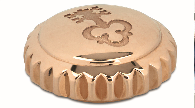

Founded in 2016 and based in the premises of Badeco SA downtown Geneva, Geneva Prod Sàrl manufactures high-precision components for watchmaking. The company produces watch crowns, push-pieces, tubes, pinions, arbors, watch hands and also components for the connecting industry, all on its Tornos turning centres.

"From the very beginning, customers have placed their trust in us, so we could start our production in optimum conditions. We have a broad base of customers, be it major watchmakers, manufacturers of watch cases, independent watchmakers, watch repairers or watch designers. "We offer products such as assembled crowns, push-pieces and tubes, pinions, screws and arbors. All of them are micro parts that feature extreme surface finish and precision and that are made of materials such as stainless steel, titanium, nickel silver or precious metals," explains Stéphane Menoni.
