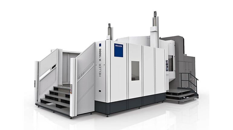

The largest producer of horizontal machining centres (HMCs) in the UK, Heller Machine Tools, has supplied a large, heavy-duty machine to GKN Aerospace Filton, near Bristol, to rough titanium aircraft components. It was installed on budget and ahead of schedule during the latter part of 2017. This year, it started producing a family of five structural components from titanium forgings, 24 hours a day, seven days a week.

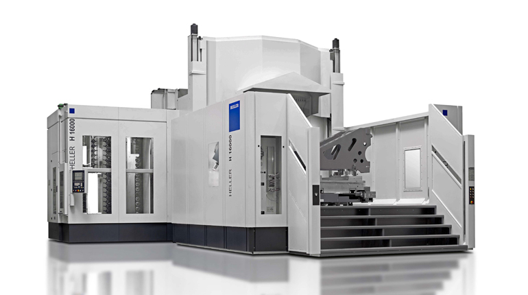

The specification of the H 16000 at Filton includes axis travels of 2,400 x 1,600 x 1,600 mm and a high torque, HSK-100A spindle rated at 2,292 Nm / 60 kW / 6,000 rpm.

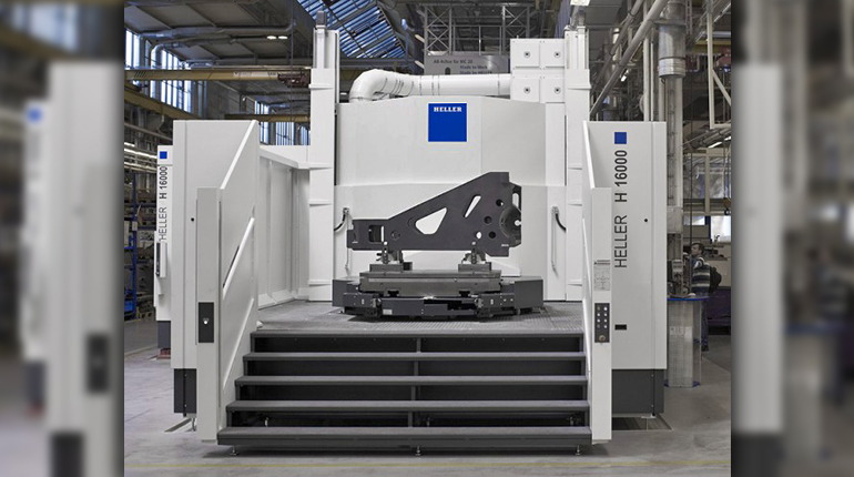

An unusual feature of this H 16000 is that it is one of very few such models built by Heller in an optional configuration without an automatic pallet changer (APC). The rationale is that if one had been integrated, the longest structural aircraft part, unless it were tilted, could not have been rotated in the 4th axis without interference with the guarding.
Little time is lost during component changeover, however, as extensive use is made of zero-point clamping on the fixture plates. Extra advantages of a non-APC arrangement are a smaller footprint and a door that opens wider, providing easier access for loading and unloading parts.
