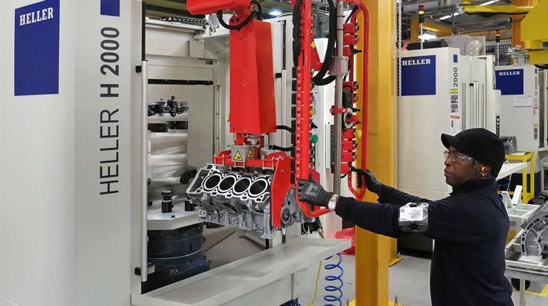

Consequently, the first two machines in the production line at Booth Drive were replaced with Hellers and the benefits were immediately noticeable. Mr Price advised, "The cycle time for each of the first two operations is one-third faster on the new machines, eight minutes instead of the previous 12.
"Impressively, the 33 percent time reductions have been achieved despite adding extra routines by including some sections of the Op 40 cycle into Op 10 and parts of Op 30 into Op 20."
The raised productivity is largely down to the rigidity of the H2000s, the higher speed (16,000 rpm) spindles with HSK63A interface and programmable through-coolant up to 70 bar, all of which allow faster cutting feed rates. Rapid traverse is quicker than before and further time savings derive from integral hydraulics for automatically clamping the engine blocks and air detect for checking that the component is seated correctly. A probe in the tool magazine for identifying broken cutters shaves off further time by removing that function from the cycles.

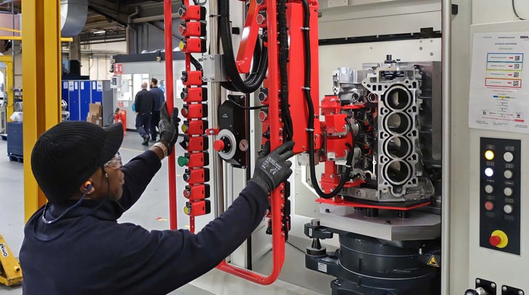

Capital expenditure (capex) approval to replace the third HMC was given by the Mahle board in mid-2017 and another Heller H2000 was ordered. Built in Redditch and commissioned at the beginning of this year, it took over Op 30 from its predecessor during February 2018. Again, the previous 12-minute cycle has been cut to eight minutes, despite taking some of the load from Op 50 as well. When the fourth H2000 assumes responsibility for Op 40, it will carry out some of the Op 60 cutting scheme in addition to delivering a more efficient Op 40 routine. By then, the TAKT time for the whole line will be 10 minutes. Performing Ops 50 and 60 on Hellers in the future will lower it further to eight minutes.
Another ongoing project at the Booth Drive facility is the reorganisation of the shop floor so that all six HMCs and the two bore honing machines are in a straight line, as at present some zigzagging is involved. That will allow two operators to be deployed on other work, one from Ops 50 and 60 and one from the honing section, helping to amortise the capex more quickly. The overhead gantry is being extended and reconfigured so that the existing Dalmec equipment can be retained for handling the 45 kg aluminium blocks in and out of the machines.

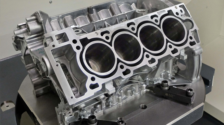

The line currently operates 24 hours a day, five days a week, saving overtime compared with when it ran 24/7 due to a previous longer TAKT time. Tight tolerances are held, including 50 to 70 microns on true position of some features and 10 to 12 microns on holes up to 16 mm diameter. Prior to honing, each cylinder bore and crank bore is pre-machined to 28 microns roundness, 0.15 mm true position and 50 microns squareness.

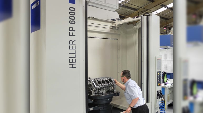

In another development elsewhere in the factory, at the start of this year a Heller FP6000 5-axis HMC built in Germany was added to a pre-existing flexible machining line that already comprised a vertical machining centre and three HMCs of a different make, all 5-axis models. During a recent open day held in the Wellingborough factory, it was explained that the line has been relaunched as a facility for the manufacture of up to V12 and inline 6 heads and blocks as well as a wide range of other prismatic parts, from one-offs to runs of up to 20,000, for customers in any industry.
Previously, the line was used for producing cylinder heads for a German OEM. To make it more suited to diverse subcontract work and to lower future fixturing costs, all five machines are being fitted with a zero-point modular plate system for workholding. When configured, the line will initially machine a variety of currently-produced components, with the potential to produce components for customers in many different sectors.
