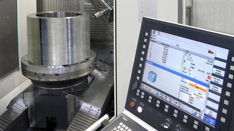

Installation of two Heller 5-axis machining centres, one with turning capability, has transformed the efficiency and repeatability with which marine components are machined at an offshore equipment manufacturer and refurbishment centre in the UK.
Previously, the process for machining cast steel components was labour intensive, involving highly skilled machinists setting up each part 16 times on manual mills, drilling machines and lathes. Lead-time from customer order to delivery was 24 weeks, partly because machining took a 40-hour man week typically spread over a month. Assembly, test, finishing and customer factory acceptance were also protracted in the manufacture and installation of the device.
The whole process has been reduced from 24 to just six weeks, as the parts can now be milled and drilled efficiently in one hit on both Heller 5-axis machining centres and turned as well in the case of the second machine. Within the family of six sizes of component, one variant for example now takes just nine hours to mill and drill and requires a further one hour for turning operations.
Investment in the Heller machines was triggered by the manufacturer's need for more process control over production of the components, as volumes were rising and there was increasing requirement for better consistency. The first Heller 5-axis machine immediately provided the required repeatability, as well as drastically reducing lead-times and eliminating freehand fettling using angle grinders.
The machine, designated FP 4000, completes all prismatic metalcutting on the casting in 3+2-axis mode. Turning is performed on a separate lathe. The second Heller machine is a CT 4000 model with an integrated, 1,000 rpm turning table, so all operations are carried out in one clamping.
Similar benefits are achieved when machining another key component, this time of stainless steel. Each is milled and drilled to within 20 microns dimensional tolerance in a 15-minute cycle on the Heller 5-axis production centres. It takes much longer to machine them manually and there was a considerable amount of hand grinding involved to ensure an accurate fit. Now, two sets of eight parts can be taken at random after machining and assembly staff know that they will fit together perfectly.

The Heller FP / CT 4000 machines offer large machining capacity of 800 mm by 800 mm by 1,000 mm in a compact footprint, with positional feedback via linear scales. The rotary table provides the fourth CNC axis and a +15 to -195 degree swivelling spindle head mounted at 45 degrees provides the fifth CNC axis in a compact configuration that does not squander Z-axis movement. Control is by the Sinumerik 840D sl from Siemens.
