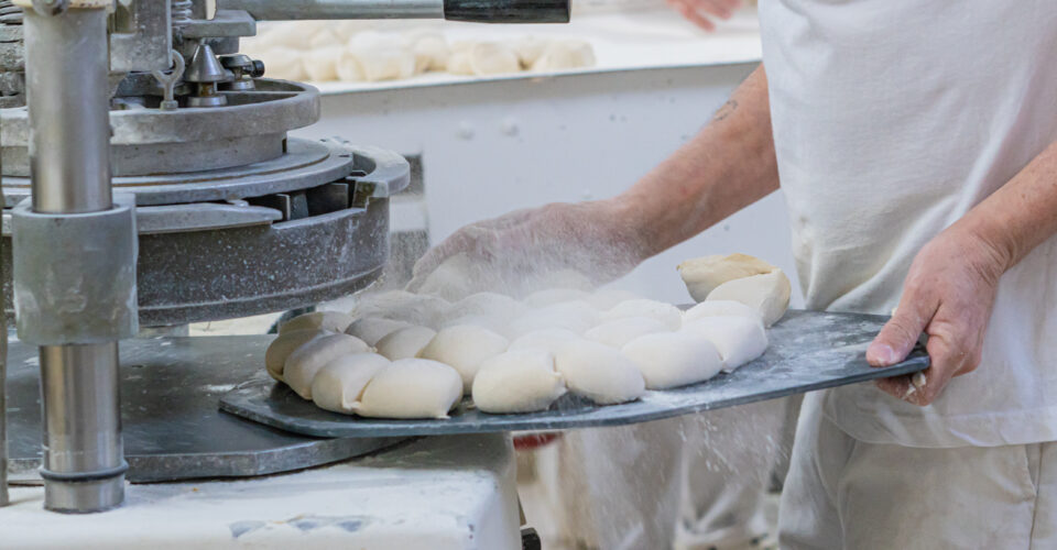

There are numerous tasks in the food production industry where the generation of flour dust occurs. This includes activities such as sack tipping, gravity or mechanical feeding of hoppers where displaced air is generated, filtering air from pneumatic conveying systems to allow clean air to return to atmospheric pressure, using dough brake roll machines, dusting products with flour and cleaning areas where flour is regularly handled.
