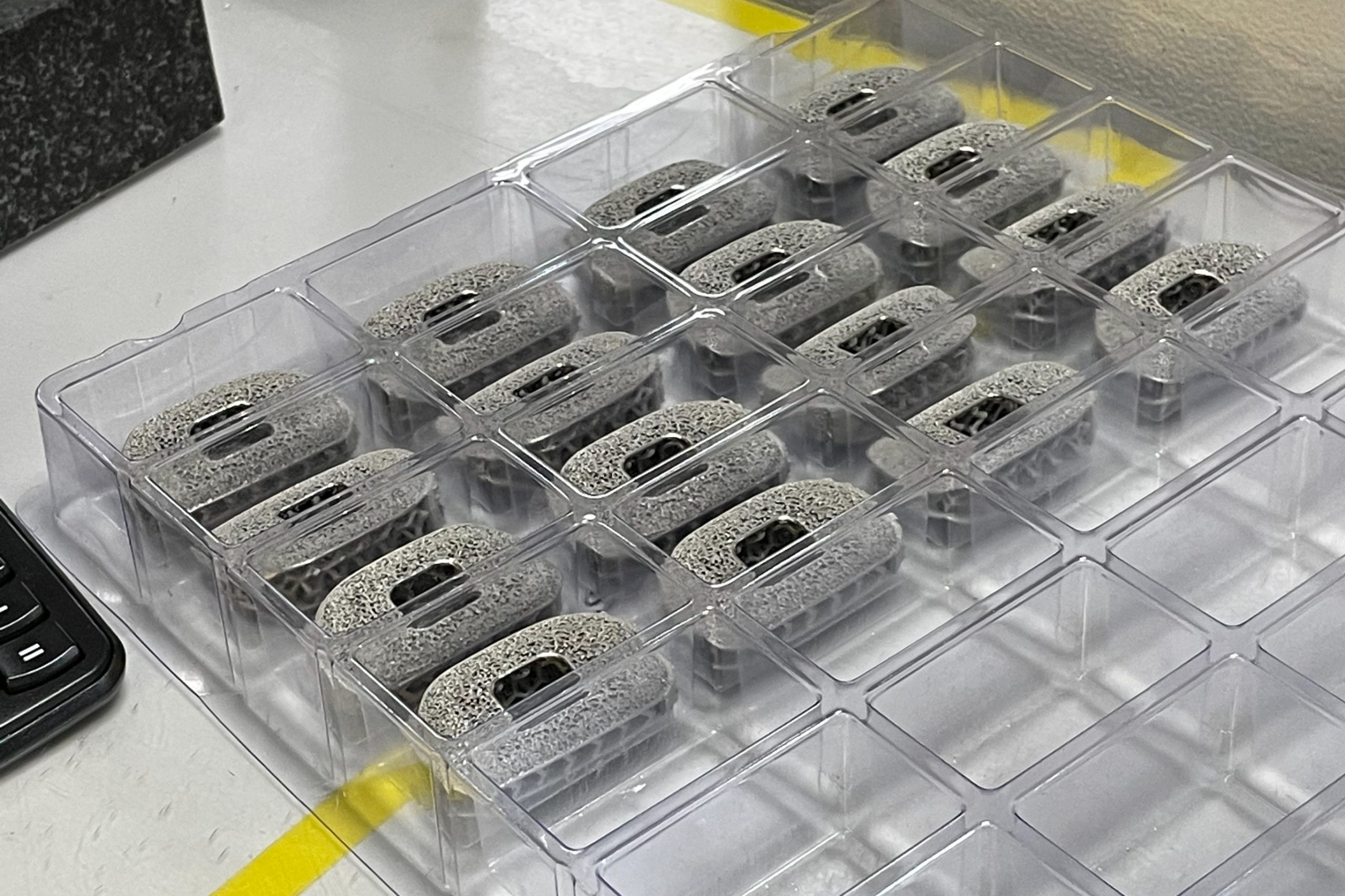

Where conventionally manufactured parts require machining away as much as 90% of the stock, additive parts are already near-net shapes that need basic operations such as drilling, tapping and machined instrumentation slots. Cycle times are much faster. Depending on the number of machined features on a part, employees could be machining between six and 20 parts per hour and switching machines over as many as two or three times per day. In addition to the differing workflows, finish-machined additive parts need to be handled differently because they are more expensive to scrap. The entire process is designed to produce zero scrap.

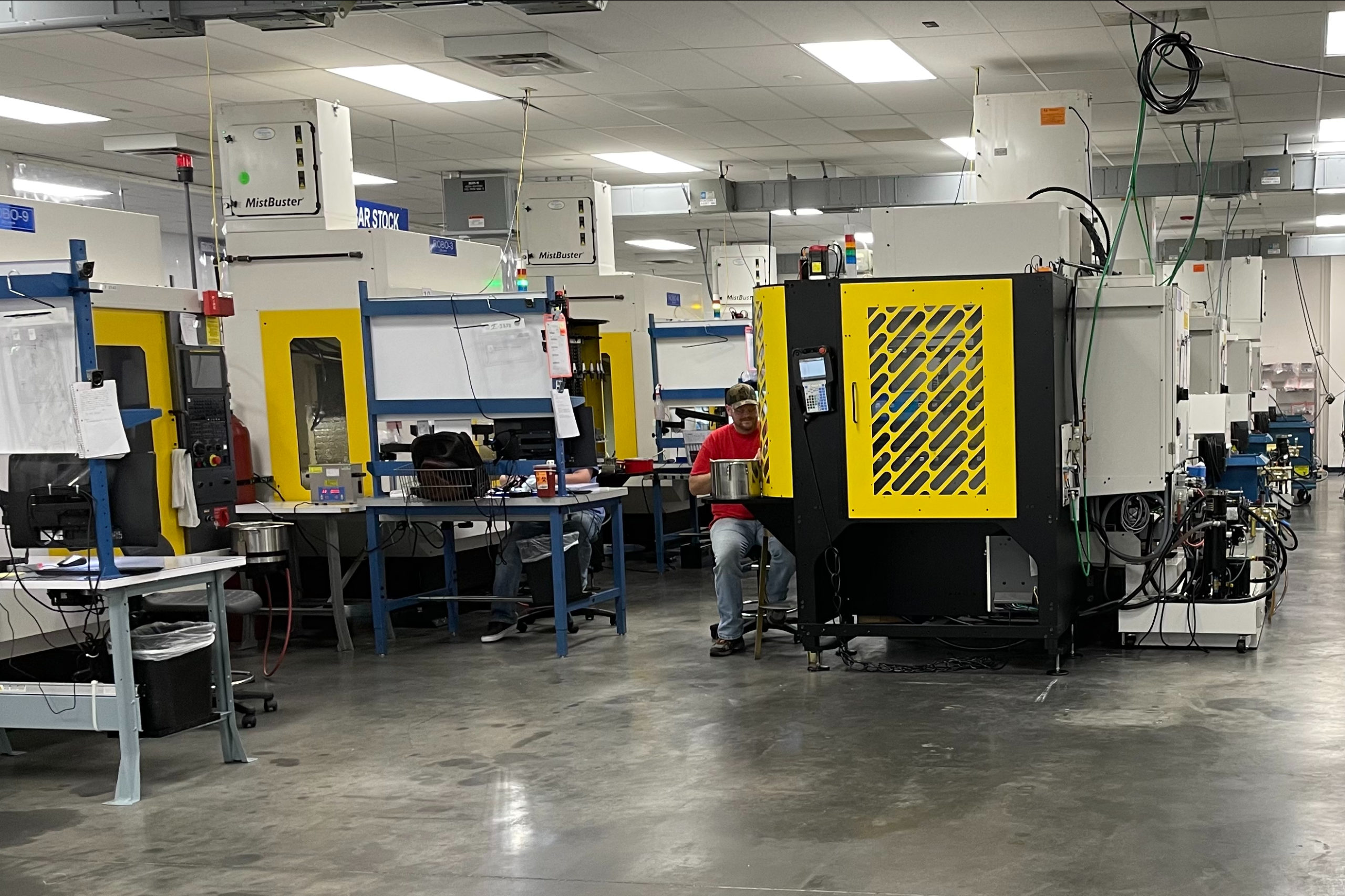

The additive machine shop is led by Aaron Glanz and consists of eight machinists on first shift, seven on second, and two on the weekends with plans to add more. Equipment in the additive machine shop is standardized, just like the rest of the company, for maximum flexibility. It has 12 FANUC Robodrills, along with three CUT AM 500 horizontal EDMs, which are specially designed by GF Machining Solutions for removing 3D printed metal parts from their build plates. The additive division also has a Haas VMC that is dedicated to resurfacing build plates, and a Haas lathe for machining AM test specimens.

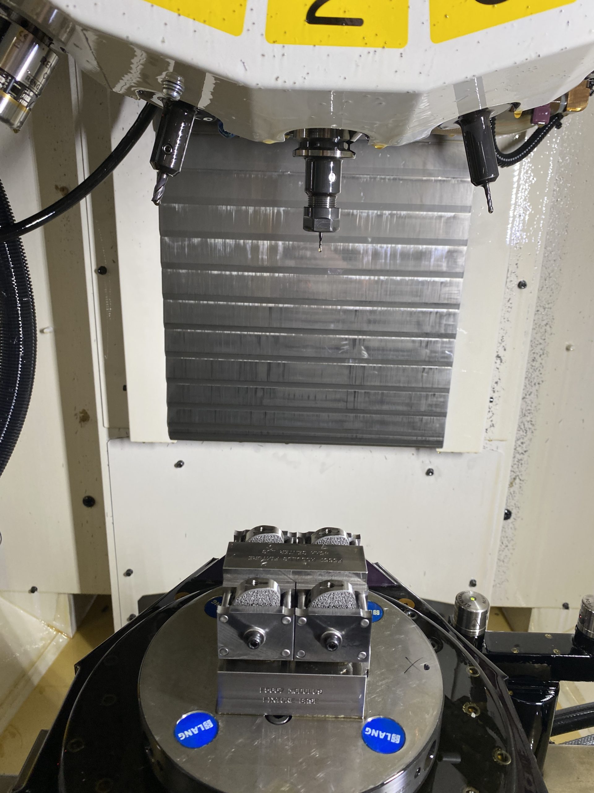

One of the biggest challenges in machining additively manufactured parts is workholding. “Machining an additive part is complicated because it’s not a piece of barstock where you have nice datums and can hog it out,” Kircher says. “You have to figure out where this part is in space, and make sure these features you’re machining on the part are in the right spot. It’s not trivial when it’s already 90% of the way manufactured.”

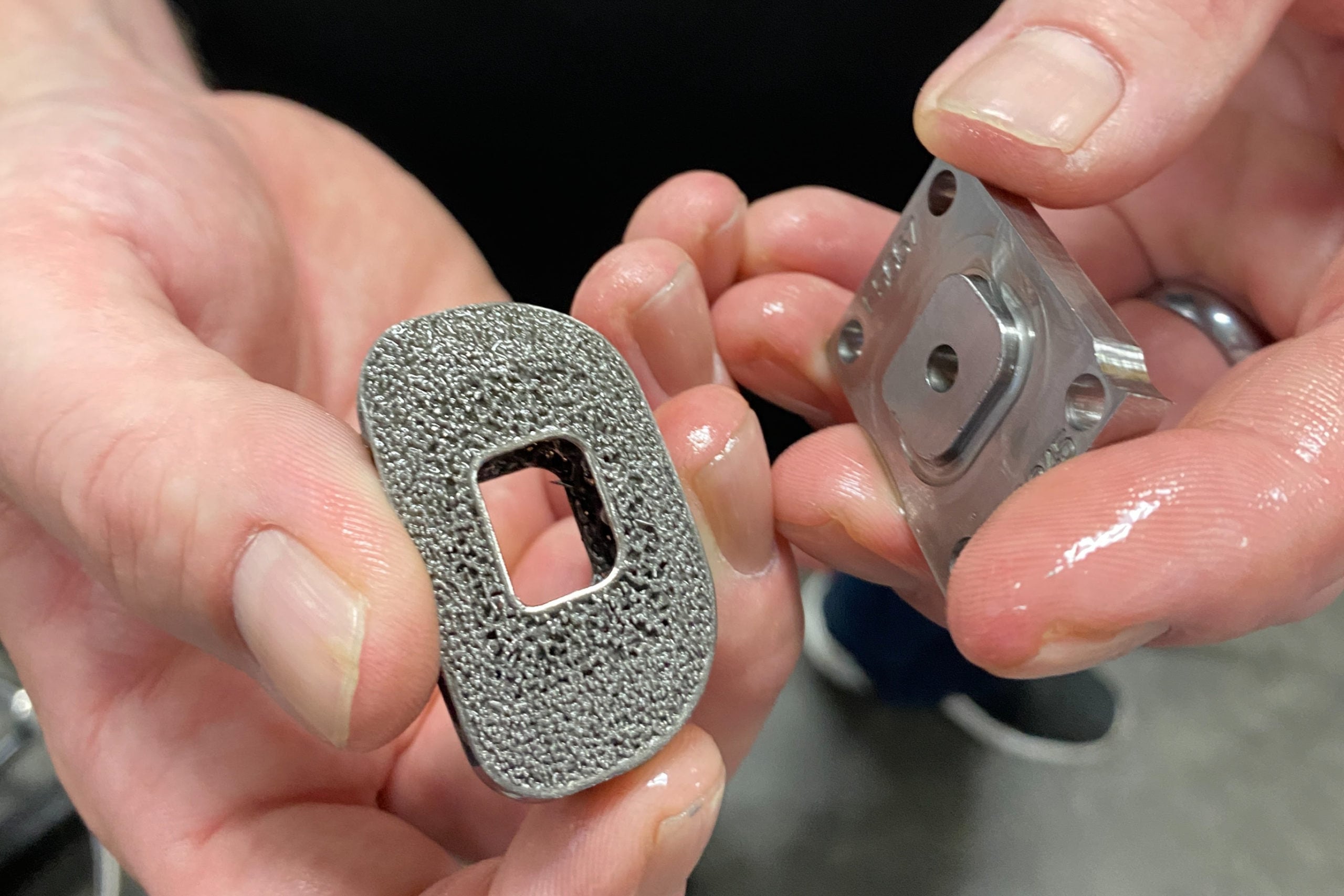

Further complicating this is the fact that all of the parts RMS 3D prints are implants with features designed for bone ingrowth that cannot be produced by conventional processes. “That’s the technology our customers are designing into their implants that we cannot damage or contaminate,” Glanz notes. These surfaces can be so intricate that they cannot even be touched with a piece of cloth. “We have to work fixturing around all that, and make sure we are not marking up their surface technology,” he adds. For example, the company designed a workholding fixture for one of its spinal implants around a hole in the middle of the part. The fixture grips this feature and holds the parts steady without damaging the surface while extra stock is machined off the ends.
