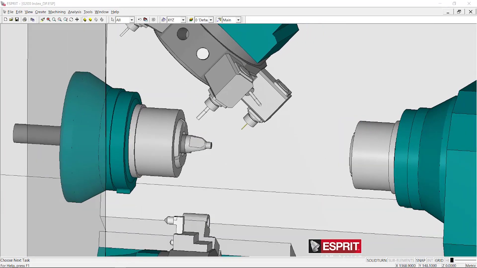

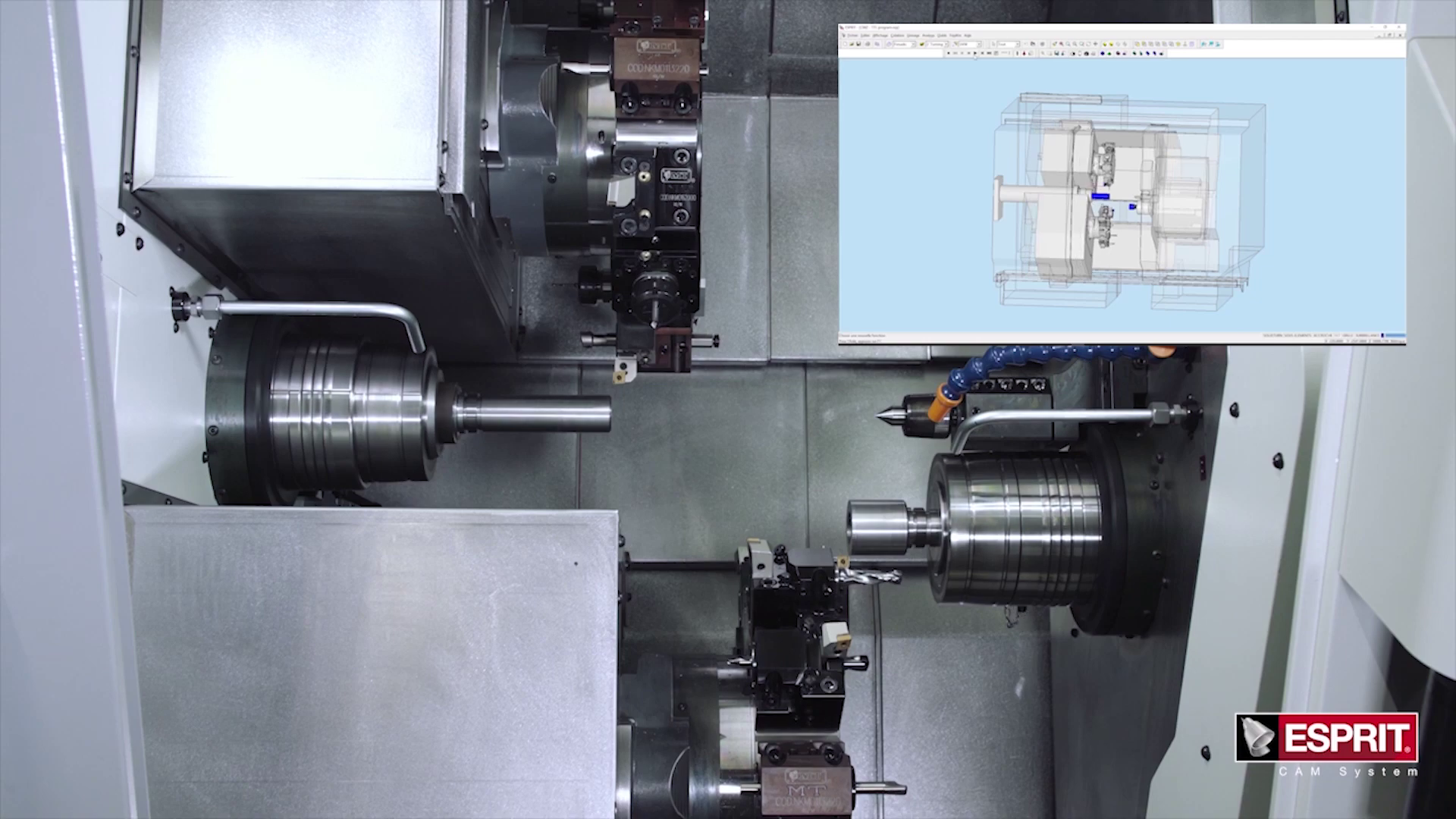

At setup time, ESPRIT’s digital twin simulation has provided significant savings in time and tooling, and edit-free NC code has contributed greatly to the enhanced productivity. “Having a solid post processor has eliminated a lot of those programming errors,” notes Scott. “If it works on the computer, it works on the machine.”

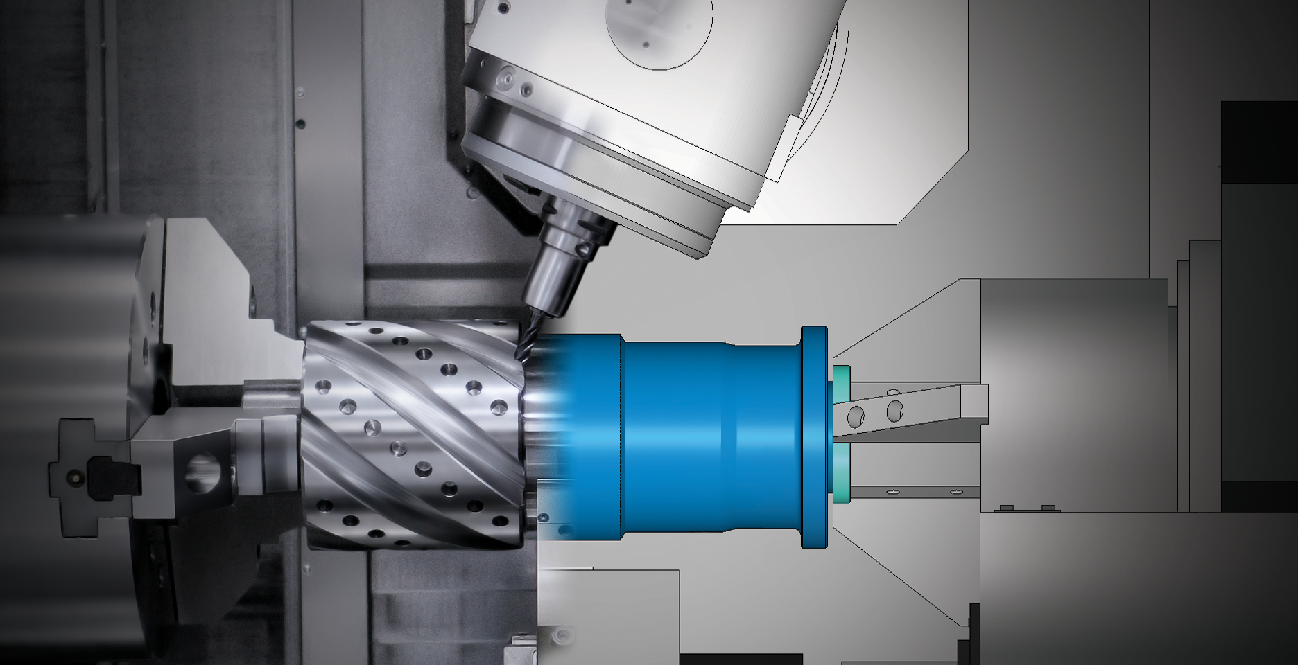

ESPRIT has enhanced productivity and part quality at Pacific Swiss, with complex wrap milling, automatic chamfering cycles that eliminate secondary deburring operations, and optimized spindle usage that allows Pacific Swiss to squeeze every bit of performance out of their already high-performing machines.
