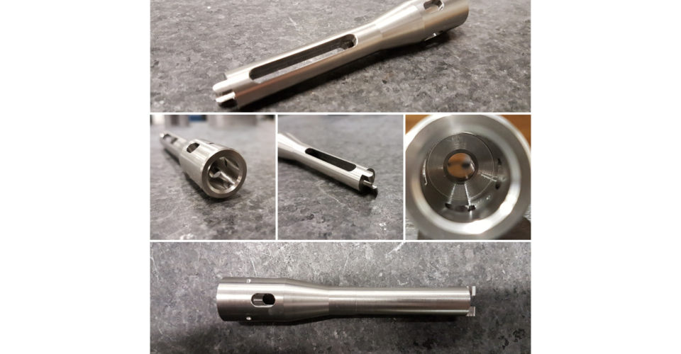

Check out this surgical part Empire have just made on their Star SR-32J. Stainless steel, the two lugs on the front are different sizes each with a full rad on. Central hole going all the way through 70mm into a 30mm flat bottom bore. Oh and a 2mm dia., off centre, cross hole which breaks through the top section of the part OD. Not to mention the 6 milled pockets along the part, oh they just did! This came off the machine complete and deburred ready to send straight to the customer.
