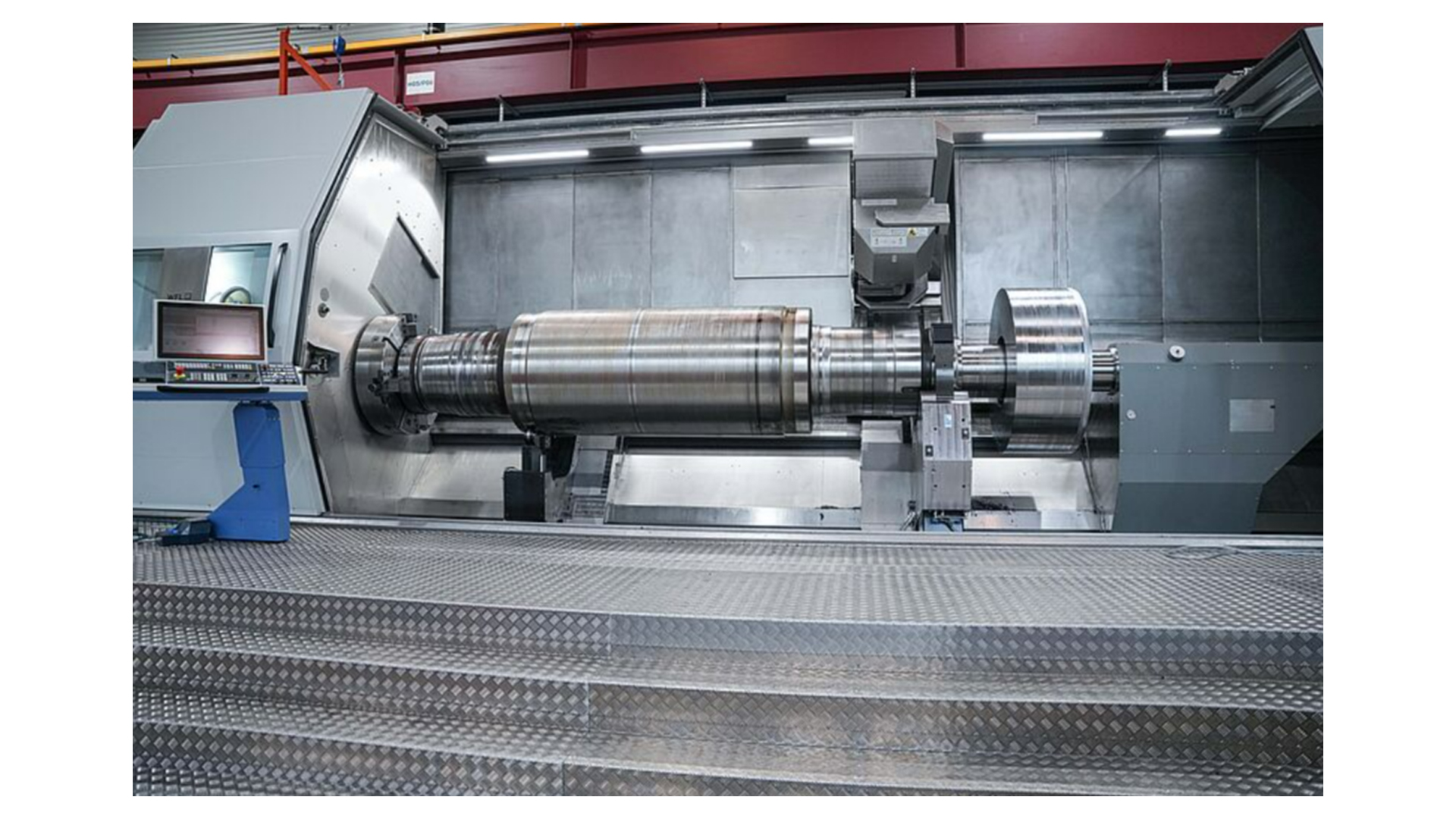

Special needs demand special measures. Gas and steam turbines or components for wind turbines, rollers, crankshafts and transmission parts in machine construction – WFL can now machine large and, above all, heavy parts with workpieces weighing up to 60 tonnes. What makes this extraordinary is that these types of heavy components can be machined in just a few clamping operations and in a single machine. A Millturn can even easily handle high-strength steel or HRSA (heat resistant super alloy) material. Special-purpose machines, such as those needed in multi-step production, are a thing of the past.

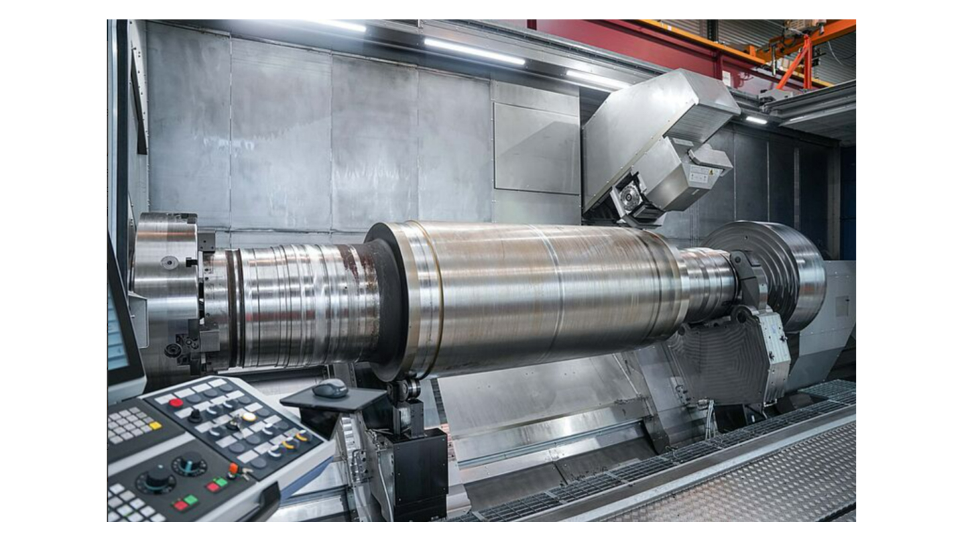

A Millturn eliminates the need for tedious changeover processes. Warpage-free and secure clamping is critical for premium quality standards and is based on the many years of experience of the WFL machining specialists. Large masses have a tendency to deform or change simply as a result of their net weight. The sag of a turbine shaft weighing 60 tonnes is so great that this needs to be taken into account when clamping the workpiece. This variable can be compensated with the correct design of the clamping device and clamping method. FEM calculation (finite element method) can be used to precisely determine how the workpiece can be correctly clamped and supported. In this case, WFL uses a rolling or hydrostatic steady rest depending on the characteristics of the workpiece. This ensures optimal machining quality and production. The accessibility to the machine with folding grate elements and tread plates also ensures the best possible ergonomics.
What’s more, the enclosed working area enables machining under high coolant pressures. The UHPC pump (Ultra High Pressure Coolant) can be used to reach up to 200 bar. This ensures an optimum tool life even with high machining parameters.

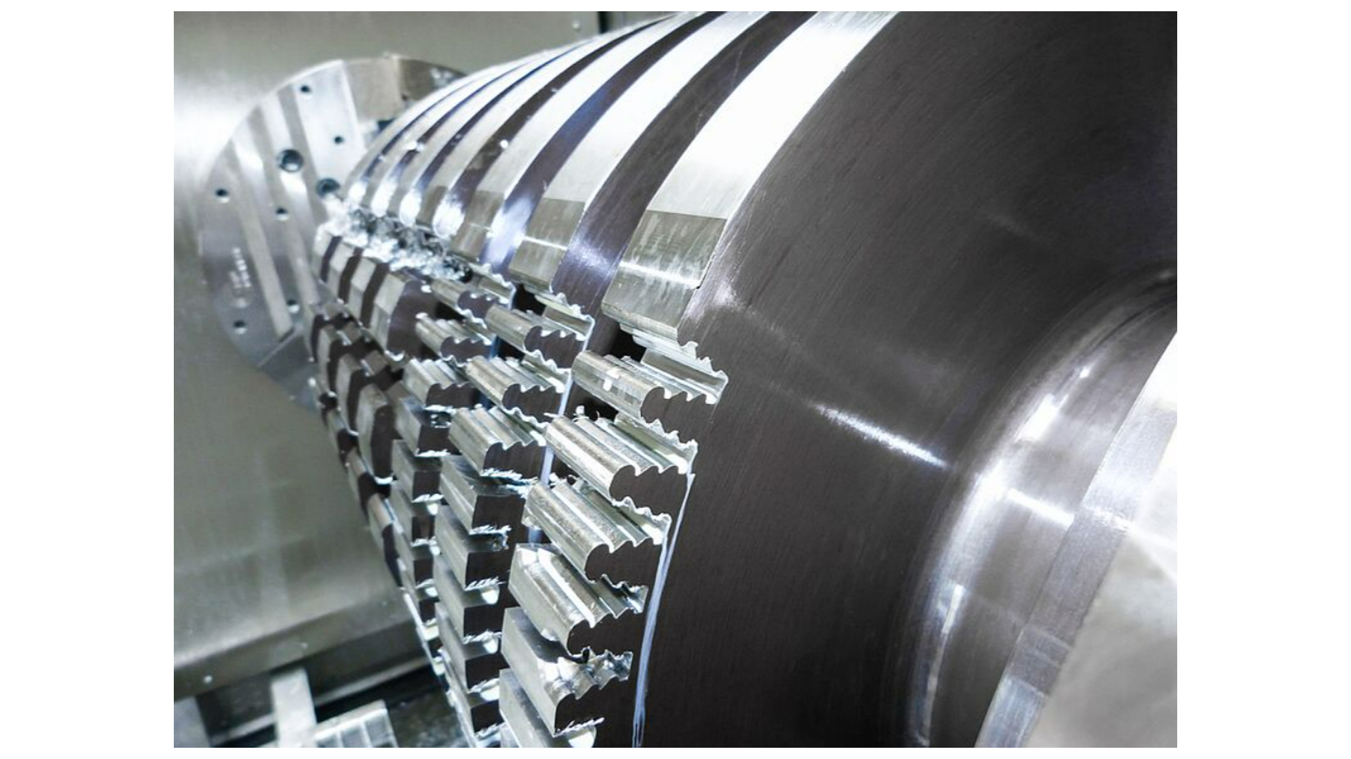

It is also possible to precisely measure the position of the workpiece in the working area. This is necessary to precisely manufacture extremely narrow shape and position tolerances, for example, fir tree profile slots or locating holes.
