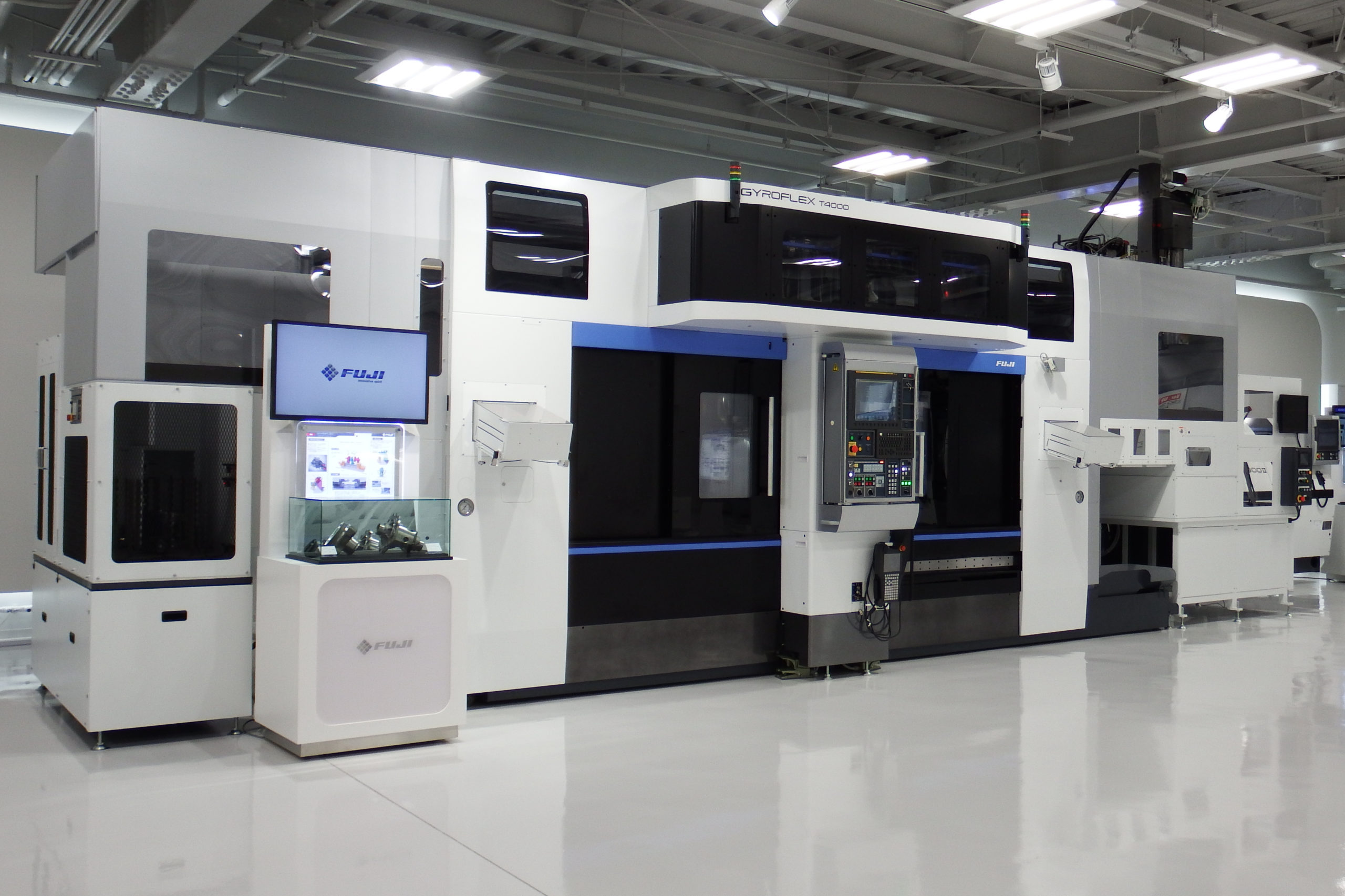

Fuji Machine America Corp., a creator of automated machine tools, combines the machining and robot experience to present a new automated multitasking machining solution with an integrated robot.
WATCH OUR REVIEW THIS MACHINE AT WESTEC in 2021 – CLICK
“Any shop that can benefit from product completion in one machine is the ideal candidate for the Gyroflex,” says Frank Tortorich, vice president of sales and service at Fuji Machine America. He explains that the machine handles the process from the beginning with the raw material, all the way through to a finished part, including measuring and testing for quality.

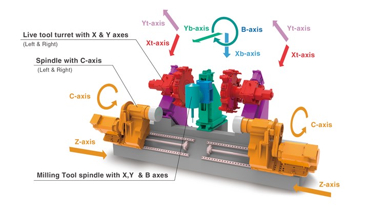

The machine’s dual-opposed main spindles for simultaneous operation, a B-axis milling tool spindle, multiple workflows, tooling capacity, integrated automation, and rigidity are among the key features of the Gyroflex.
Dual-opposed spindles. The machine’s opposed twin spindles positioned on Z-axis slideways are equal in size and machining capability. They can perform the same operations (op-10a/10b) or can pass a part from the first spindle to the second while maintaining positioning accuracy, thereby performing op-10 and op-20. If the application calls for two separate operations, a partition inside the machine is used to create two separate workzones. Also, the Z-axis slide can move at high speeds to reduce loading time to the second spindle.
B-axis milling spindle. The B-axis milling spindle is mounted on rigid X- and Y-axis boxway slides. The spindle accesses the two Z-axis spindles and swings up to 190 degrees, enabling different types of operations, including turning, drilling and part probing. Further, the B axis and the tool are clamped by curvic coupling, resulting in accurate index location with the turret precisely centered, according to the company. Gyroflex also comes standard with Sandvik Coromant Capto C6 toolholder interfaces, which provide virtually unlimited combinations of tooling for all different types of applications, Tortorich explains.
