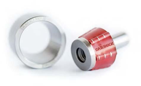

The CENTREX DUO positioning and centring element has been a standard component of HAINBUCH modular solutions for many years. The simple taper-bushing design is found in classics, such as the MANDO Adapt mandrel adaptation, as well as in the capteX and centroteX quick change-over systems.
Hainbuch’s new CENTREX DUO is a manual centring system of extremely high repeatability (≤ 0.003 mm) and simple handling. It can be easily integrated into custom designs with its flexibility, even in the smallest of installation spaces.
Designed for heavy-duty handling, the absolute zero point maintains its self-centring perfectly, even under thermal expansion. CENTREX is not affected by swarf or chips. A huge advantage is that the system is completely separated from the draw-in mechanism and thus it is extremely precise – even at high draw-in forces.
