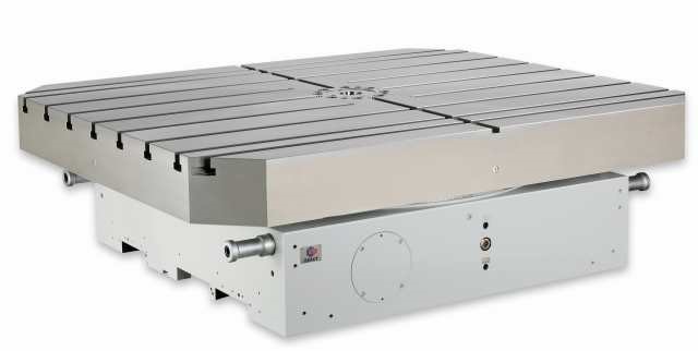

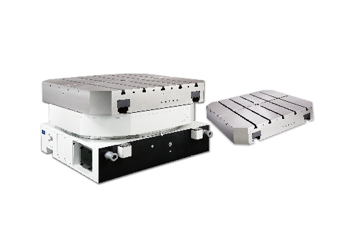

The HC range of automatic indexing tables can be used with the worktable in either the horizontal or vertical plane, and are suitable for use on machining centres, rotary transfer machines and almost any type of manufacturing system. Sizes range from 200 to 500 mm diameter, and up to 1,800 x 1,800 mm for the heavy duty models. Rotation is by a worm and wheel driven via a servo motor, hydraulically clamped through a three-piece coupling that generates a resistance to high machining forces for outstanding positioning accuracy and rigidity.
Featuring a non-lifting, Hirth coupling design that has an exceptional holding force and a working surface that does not raise and lower during indexing, it allows a solid sealing system to prohibit swarf, chip or cutting fluid ingress into the housing for reliability and longevity. Hydraulic rack and pinion drive with built-in cushions ensure smooth operation with optimum cycle times; the table clamp and unclamp functions are hydraulic and monitored for safety by feedback switches.
