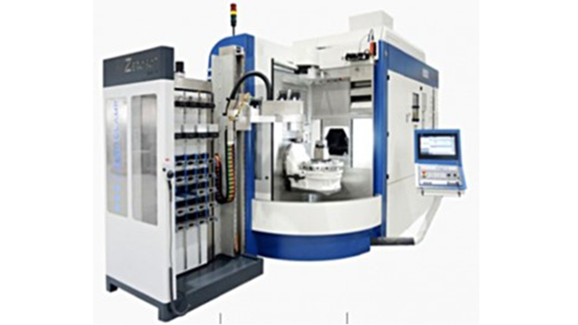

At the heart of the loading system is the robot and different robots are designed for different kinds of environments. The Zerobot 100V eco is an industrial grade SCARA arm robot, a design that has become popular for machine loading in the manufacturing sector. It is designed to work in the swarf-covered, coolant-dripping environment encountered in the machine tool world.
Robots are usually specified by reach and payload. The Zerobot 100V eco can be specified with a right- or left-hand mounting of the arm with a radiused reach of 1.2 m providing enough range to access the whole worktable of most machine tools. While the 100 kg total payload means raw material billets or forgings up to 250 x 160 x 200 mm can be accommodated.
The infeed and storage of raw materials and finished workpieces is another area for consideration. Here, the Zerobot 100V eco offers a manually operated double-sided vertical rack system with the flexibility to be populated to exactly match the requirements of the components being processed. The double-sided rack design means finished parts can be removed and the raw material supply can be refreshed while the machine tool is operating, so downtime is kept to an absolute minimum. It also allows access to the machine’s working envelope if an unscheduled part needs to be manually loaded, supporting emergency repairs or rework scenarios.

The extensive range of Zerobot robotic automation systems means there is a solution available for almost every application. Starting with the Zerobot 100V eco with fixed double-sided rotating rack, no automatic gripper or automatic fixture change. Automatic rack rotation available as an option and, being such a straightforward design, it offers a simple I/O interface.
Next is the Zerobot 100V featuring a double-sided automatically programable rotating rack, automatic gripper and fixture change options, and field bus interface with NC-program selection.
Offering two single racks that can be moved with a pallet truck, the Zerobot 100P has an automatic gripper and automatic fixture change option, with field bus interface for NC-program selection.
The most extensive of the Zerobot range is the 100S that comes with an additional linear axis for longer travel, two or more single rack systems that can be moved with a pallet truck, automatic gripper and automatic fixture change options, and a field bus interface with NC-program selection. When the additional linear axis for longer travel and more than two single rack systems are not required the 100S can be downgraded to the 100P system.
