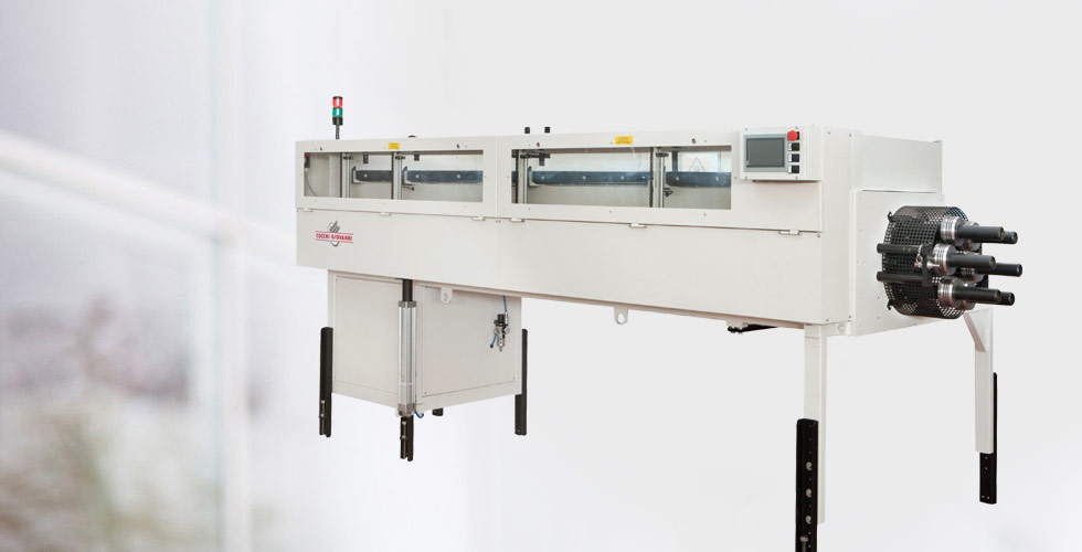

The DBM and DBMF multiple channel bar feeders are the most popular systems supplied by Cucchi Giovanni. Developed to minimise the production floorspace required the bar feeders feature Siemens PLC systems and touch-screen display to control each function of the loader. Bar diameters range from 3 to 80 mm depending upon model specified, while the standard maximum bar lengths of 3,300 or 4,100 mm can be customised to suit specific applications.
The guideways for the raw material are manufactured from reinforced nylon with exceptional resistance to the wear and abrasion caused by the rotation of the raw material, even if the bars have an irregular profile. Another benefit of this nylon’s properties means that the surface of soft materials are not marked or scored. A further new feature is the fact that the guideways are bayonet coupled and easily interchangeable with the aid of a special key, without having to disassemble the bases that anchor the drum. Replacing the guideways for smaller bar diameters is therefore considerably simplified and very quick to achieve. Finally, they enable vibrations and the usual noise levels to be reduced by around 70 per cent. This is mostly due to the fact that the guideways are assembled by slotting together and therefore, with their ends crossing, form a perfectly cylindrical channel. So, the bar stock does not encounter any breaks or opening and can reach high rotation speeds without collisions.
Bar storage is a slant feed gravity rack for the DBM or a bundle for the DBMF with a 1,200 kg capacity. Bar loading time is just 6 to 14 seconds depending on the configuration of the system.

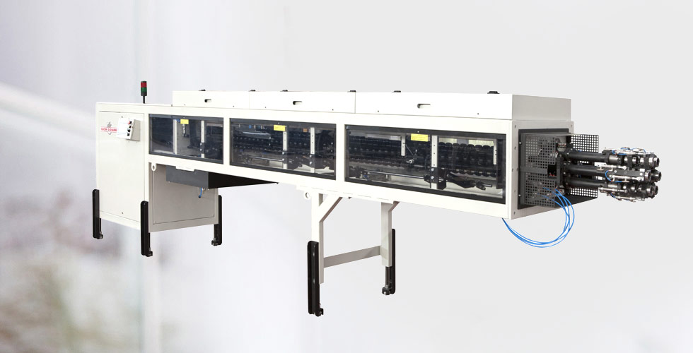

Also designed to enhance multi-spindle turning operations the company’s CMSP multi-spindle feeder combines advanced technological solutions that rank it first in its class. Within a very small footprint, just 450 mm longer than the stock material length of 3.3 m or 4 m, the standard version of the loader has a tilted bar magazine in the upper part, with the optional possibility of a bar bundle magazine with a capacity of 1,200 kg.
Loading of the bar in the carrier channel and its subsequent feeding are fully automated. Feeding is performed by two hydraulic motors; the first inserts the bar in the spindle of the lathe and the second for feeding. The diameter of the bars which can be loaded can be changed in a few minutes, merely by replacing the bar feeder collets and adjusting the bar centring devices.
The pneumatically controlled bar centring device allows perfect alignment of the bar just before it enters the spindle of the lathe, eliminating impact and vibrations, and considerably reducing noise and increasing machining precision.
Supporting efficient operation a remnant pick-up device extracts the last crop end of the raw material from the collet of the bar feeder rod and unloads it into the rear part of the loader, checking whether it has been recovered and unloaded by the collet and stopping the lathe in the event of a fault.
