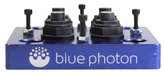

This workholding solution also allows workshops to reap the full benefits of a multi-axis machine tool. For example, most traditional workholding systems used with net shaped parts will have tool interference issues when used on a 5-axis machine. With Blue Photon’s workholding adhesive solution, engineers can configure the grippers in a location that will maintain the necessary clearances around the workpiece, allowing for five- and even six-sided access to the part. When used with billet material, dovetails and edge clamping can be eliminated.

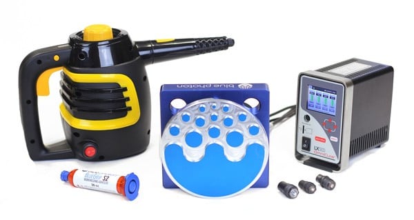

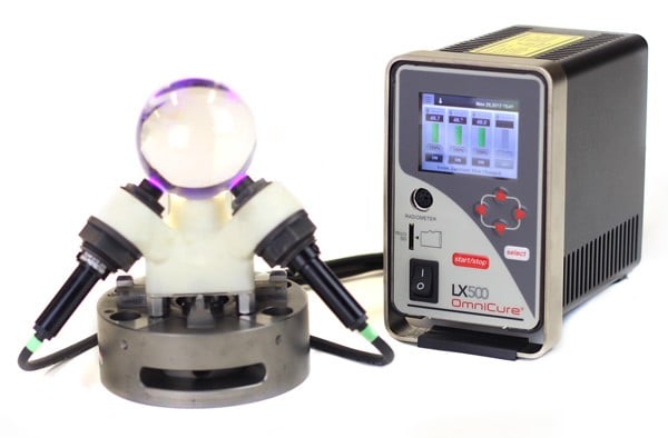

Mark Jones states: “The application of Blue Photon is straightforward; the adhesive is applied to the sapphire crystal face of the UV curing/holding units that are fed by a high intensity light source. The raw material or workpiece rests in the fixture with an adhesive gap of between 0.5 and 3 mm between the optical curing unit and the surface of the workpiece, and in under 2 minutes the activated adhesive cures to securely hold the part ready for subsequent machining operations.
“Once all machining operations are complete the adhesive bond is broken by a shearing force applied to the unit using a hex socket and wrench. Any residual adhesive is removed with a high temperature cleaner typically above 65 oC and the units are ready to be dried and used again.
