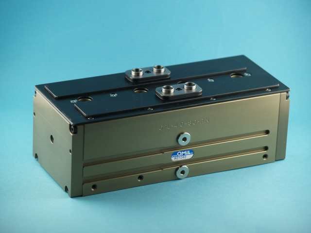

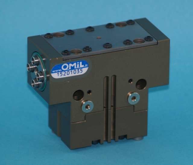

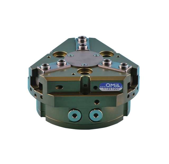

The range of pneumatic grips offered is as diverse as the industrial applications supported, from two-finger parallel to three- or four-finger self-centring and two-finger radial. As an example of the exceptional level of engineering applied to its products, the OMIL GSO range of two-finger parallel grippers is manufactured to ensure protection to class IP67 for harsh environments. An oval cylinder is used for higher gripping forces, between 123 N for the smallest unit with 5 mm stroke and 1,640 N for the largest with a stroke of 32 mm. A mechanical gripping force maintenance device ensures a minimum gripping force even if the air pressure drops.
For applications where larger and heavier workpieces require gripping OMIL has a number of ranges that provides strokes up to 400 mm and gripping forces of 10,000 N at normal workshop pressure of 6 bar.

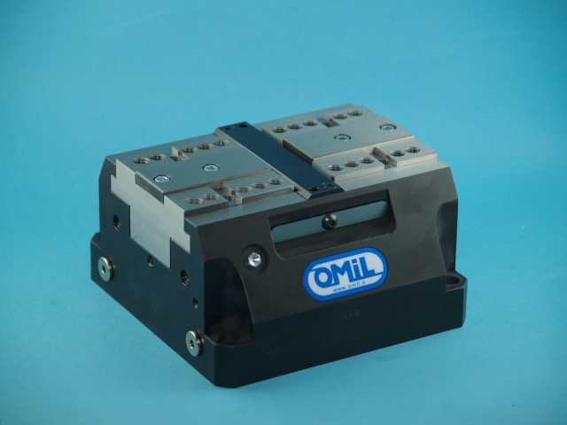

For milling machine applications, a range of chucks for round parts and vices for prismatic parts are available, while special machinery applications can encompass punching and forming equipment as well as measurement and inspection systems.
